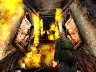

As a Silent Hill fan, my Halloween front yard is always inspired by this video game franchise. This creation is not a re-creation of something that exists in the game, but it's in the same spooky style. My two main inspirations are from these scenes in Silent Hill (PS1) and Silent Hill 2 (PS2) where you have those things hanging on the walls.
