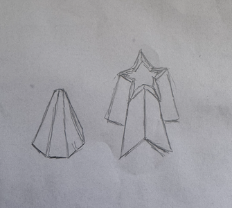

Step 1: Sketching the Designs
I began by sketching how I wanted the chocolates to look, remembering that the final form would mirror these designs.

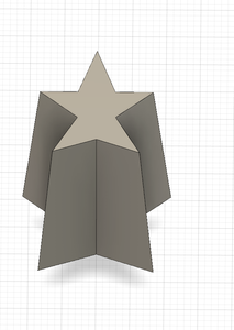

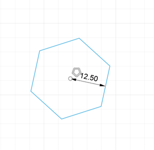

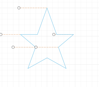

Step 2: Modeling in Fusion
Using Fusion’s sketch tool, I created my designs while considering the dimensions of the casing (38 mm). To fit properly, each design had to stay within a 30 mm diameter, leaving a 4 mm clearance from the outer edge.

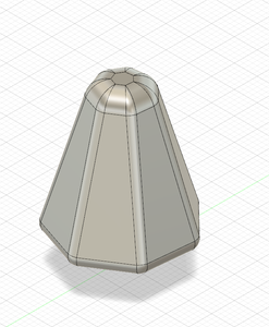

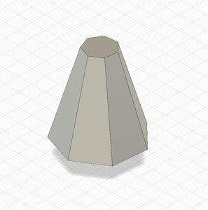

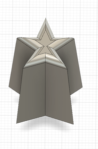

Step 3: Extruding With Draft Angles
I press-pulled the sketches into 3D forms, keeping in mind the casing height of 37 mm. The top of each form had to stop at 30 mm, and I added a minimum 3° draft angle to ensure smooth release from the silicone mold.

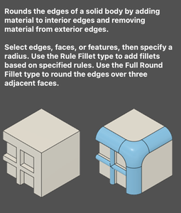

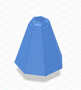

Step 4: Refining With Fillet Tool
Using Fusion’s fillet command, I rounded and softened edges, creating more complex, organic 3D shapes beyond simple extrusions.

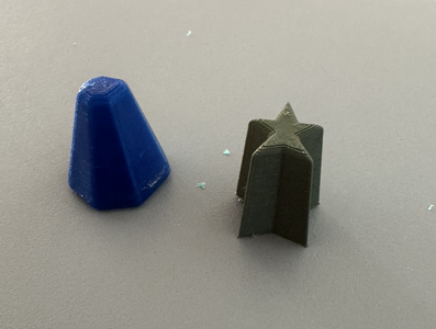

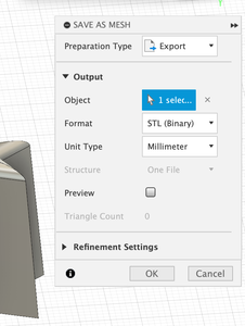

Step 5: Preparing for Printing
I saved the designs as mesh files and queued them for 3D printing.

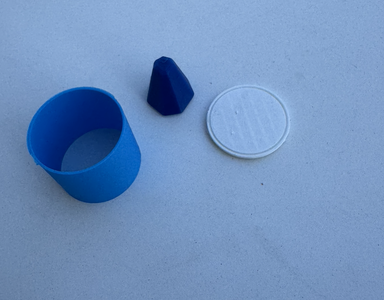

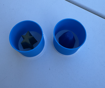

Step 6: Attaching to the Casing
Once printed, I super-glued each 3D form to the casing lid, then snapped the lid and casing together securely.

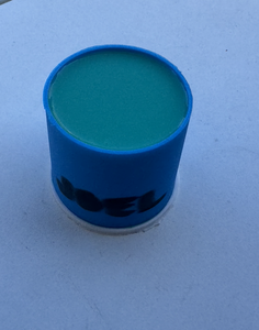

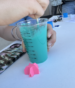

Step 7: Mixing Silicone
Measure and mix the silicone ingredients, carefully stirring to remove air bubbles.

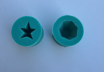

Step 8: Casting the Silicone
The silicone mixture was poured into the casing and left to cure fully.
Step 9: Adding Chocolate
After removing the cured silicone mold from the casing, I filled the cavities with melted chocolate and let it set.
