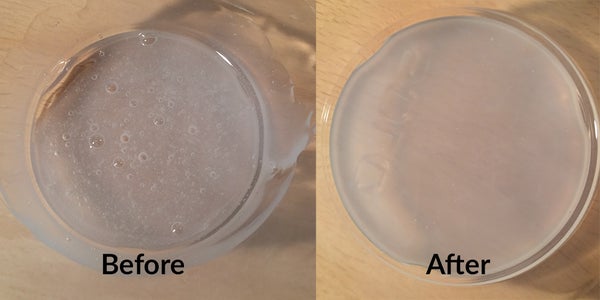

Mix your silicone part A and part B according to manufacturer instructions in a plastic cup (if using Dragon Skin 30, it is just 1:1). The mixing process will produce a large amount of bubbles. To get rid of the bubbles a vacuum chamber will be needed for this step (A bunch of small bubbles actually look kind of cool, but if you inject a very large bubble, it will cause a large void in the ring). Place the cup in the vacuum chamber, and pull as close to a full vacuum as your equipment is capable of. In my case 26.5 in Mg was sufficient to remove all the bubbles in about 1 minute.
With your silicone ready to go, it is time to move quickly to the next step.
