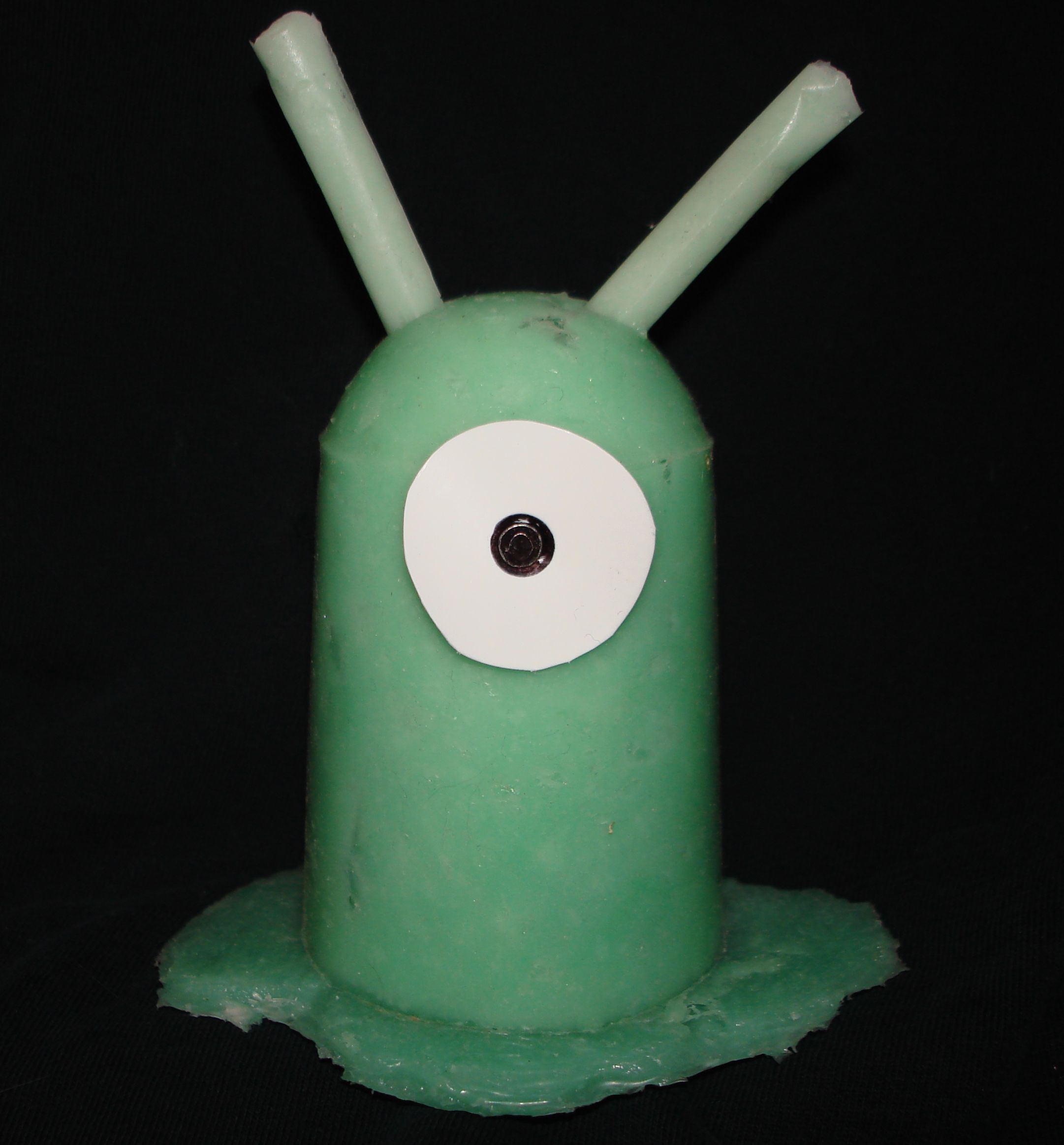

Step 2: The Mold
The mold takes advantage of oogoo's handy trait of not sticking to some plastics, hot glue or duct tape. For the main vertical part of the body I simply cut off the top and bottom lips of the yogurt container so that I was left with a smooth conical cylinder. The dome part was made by covering half a ball in hot glue. Next I pealed back this layer till I was left with a little half spherical shell of hot glue. Dabbing rubbing alcohol around the edge of the shell really helped here to release the hot glue bonds to the ball. Using the hot glue gun tip I melted holes for the antennae to stick through. I then hot glued the dome and body together. The foot/base part is just some cardboard with a hole in it hot glued to the bottom of the yogurt container. On top of that I put duct tape and used hot glue to make a thin wall in the shape of the foot. The antennae themselves were molded by just smearing some oogoo on wax paper and then rolling the wax paper into a tube shape.
Step 3: The Oogoo
I used a 1:4 cornstarch to silicone mixture (by volume) to make the oogoo nice and translucent. Food coloring goes a long way and I figured out how much to use by experimenting when I was first making the antennae. For the main body I combined the starch and silicone together and then added just 2 drops of green food coloring. Having made the antennae first also allowed me to simply bend the antenna tube in a “U” shape and insert it through the holes in the dome to secure it in place. Next I transferred my mixed up green oogoo to the mold using a large paint mixing stick and then pushed it against the walls using a plastic knife. The walls ended up being about 5 mm or 3/16th an inch thick.
Step 4: The Eye
I made the eye by tracing the outside and inside diameters of a washer onto white plastic. I cut around the outside of the washer to make the general circle, then filled in the inside diameter with marker to make the pupil. To secure it, I bent a small nail into an “L” shape and pushed it through both the eye and the body of the brain slug. I finished up by coloring in the nail head so it blended in with the pupil.
