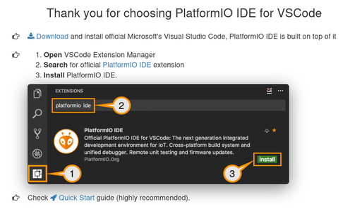

Step 3: Preparing the Environment
Go to https://platformio.org/platformio-ide and follow the installation instructions.
In PlatformIO IDE click "Clone GIT repository" and paste the following URL:
https://github.com/arduinocelentano/ssid
PlatformIO should automatically download the project and the libraries it depends on.
