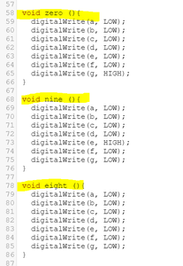

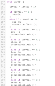

Step 7: Brief Overview of Code
The images above showcase some vital parts of the code. The first picture shows how we created 10 different void functions that ensure the 7 Segment Display is working correctly. It also clearly shows how the circuit will know how each number looks like as it allows the program to understand what segments of the display need to be lit up. Next, we can the two functions that show whether the user's input is correct or incorrect. If the user entered the incorrect pattern, then the program will create a loud sound using the buzzer and will set all of the LED values to LOW (meaning that they are off). However, if the person is correct, then all the LEDs will turn on and then turn off, while the buzzer will make a nice sound. Finally, the last image shows the series of void functions that tell the 7 Segment display when to display each value (depending on what level the user is on). By understanding these simple parts of the code, you will have a much greater experience coding your own game!
