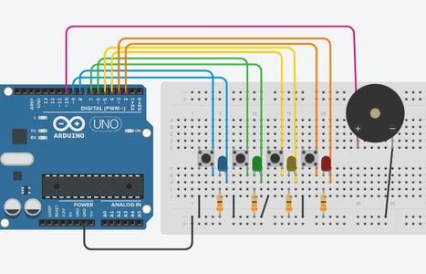

Step 1: Setup Your Bread Board
The first step is to starting any project is to set up your power and ground. As you can see in the image above Ground being sent to the ground lane. In this particular project all the power will be received from the pins so there is no need to set up the power lane.
Before starting any project it is good practice to test your materials to make sure they are indeed working accordingly. Particularly LEDs in this project were tested before any building took place. This included connecting the anode to power and the Cathode to a resistor that connected to ground. This simple test should turn the LED on, confirming it is functional and appropriate for use.
Step 2: Buttons
Secondly, place your four buttons on the breadboard in succession like shown above. Have atleast two column space in between each button. Connect the button terminal 1a to ground for each button.
Step 3: LEDs
Next, place your LEDs next to their corresponding button. Note that it would be most convenient that the corresponding and LED are in close proximity with each other in order to make the game easier to play. Connect the Cathode of the LEDs to ground using a Resistor (330 Ohm resistor is the best recommendation).
Step 4: Pins & Piezo
Now connect your LEDs and buttons to the pins in the Arduino.
For the Blue LED we connect the Anode to pin 9 and for its correlating button's terminal 2a to pin 8. Continue this for the rest of the buttons. The blue, green, red, and yellow LED's would be connected to pins 9,7,5,3. The blue, green, red, and yellow buttons would be connected to pins 8,6,4,2. Notice how the LED's are connected to the odd pins and the buttons to the even pins. This will be important later in the code.
Place your piezo on your breadboard and connect the negative end to ground and positive end to pin 10 on the Arduino.
(Note that the corresponding pins and components can be rearranged. However these are the pins referred to in the code)

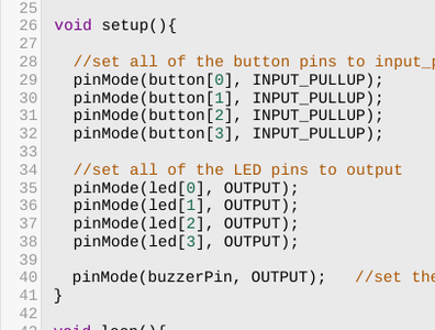

Now we can start writing our void setup. Here we will define all the button as outputs and set all of the button pins to input_pullup. Input_pullup allows the buttons default state to be HIGH. Here we will also define the buzzer as an output device. So we write:
void setup(){
 pinMode(button[0], INPUT_PULLUP);
 pinMode(button[1], INPUT_PULLUP);
 pinMode(button[2], INPUT_PULLUP);
 pinMode(button[3], INPUT_PULLUP);
pinMode(led[0], OUTPUT);
 pinMode(led[1], OUTPUT);
 pinMode(led[2], OUTPUT);
 pinMode(led[3], OUTPUT);
 pinMode(buzzerPin, OUTPUT);
