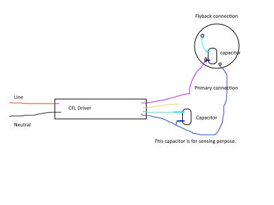

Step 2: Why My Way )_( 1 Cm to 1 Inch
By using a single component the arc gap can be boosted from 1 cm to 1 Inch. Yes by connecting a 245KJ 400V Capacitor as shown in the figure the Out put voltage is increased. The secret. How ever prolonged use will heat up the capacitor.
