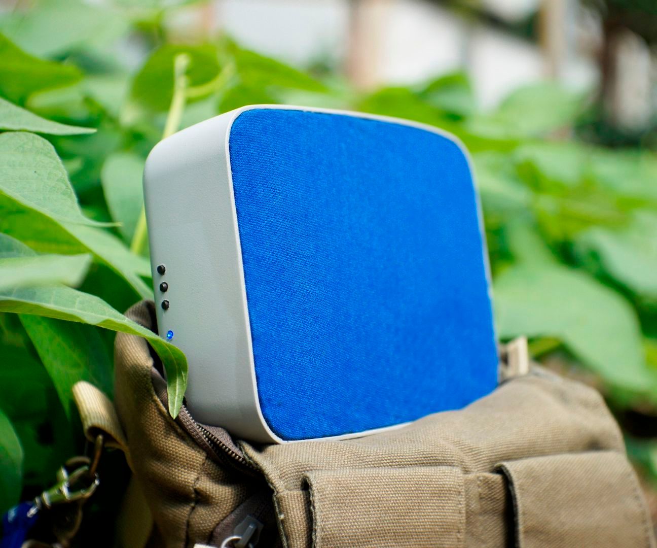

Hey everyone! Today I'm going to show you how I built this super simple 10 watt bluetooth speaker - an excellent companion for these summer months! I've been designing, refining, and tweaking this speaker design over the past few months, and I'm happy to say that it's now as simple, affordable, good looking and good sounding as it can possibly be! This speaker is based around a 1 cell battery, all wrapped up in a multi-layer plywood enclosure.
Specs:
- 5W output per Channel
- Bluetooth 4.0 with Qualcomm aptX codec
- Micro USB Charging
- 10 hour battery life on high volume
- (Optional) function buttons
- Dual 50mm drivers, single passive radiator design
