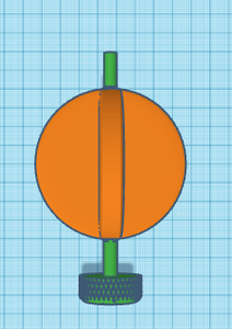

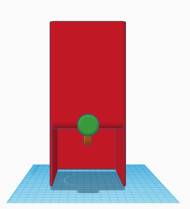

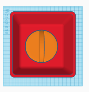

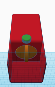

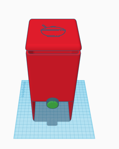

I used a simple CAD software known as Tinkercad to create all the necessary components.
It consisted of a main body, a lid, a handle and of course the blade that pushed cereal out.
