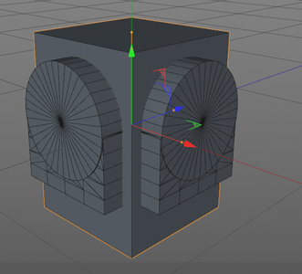

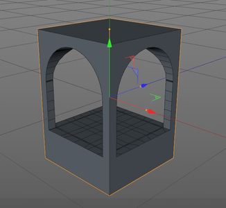

We basically start with a cube and a cylinder, then joined them together to make an archway toped cube, we then added another cube and cut the original form out, we then used a pyramid primitive and resized it to fit to top. We cut a cylindrical hole in the pyramid to add a tie-wrap hanging loop hole.
