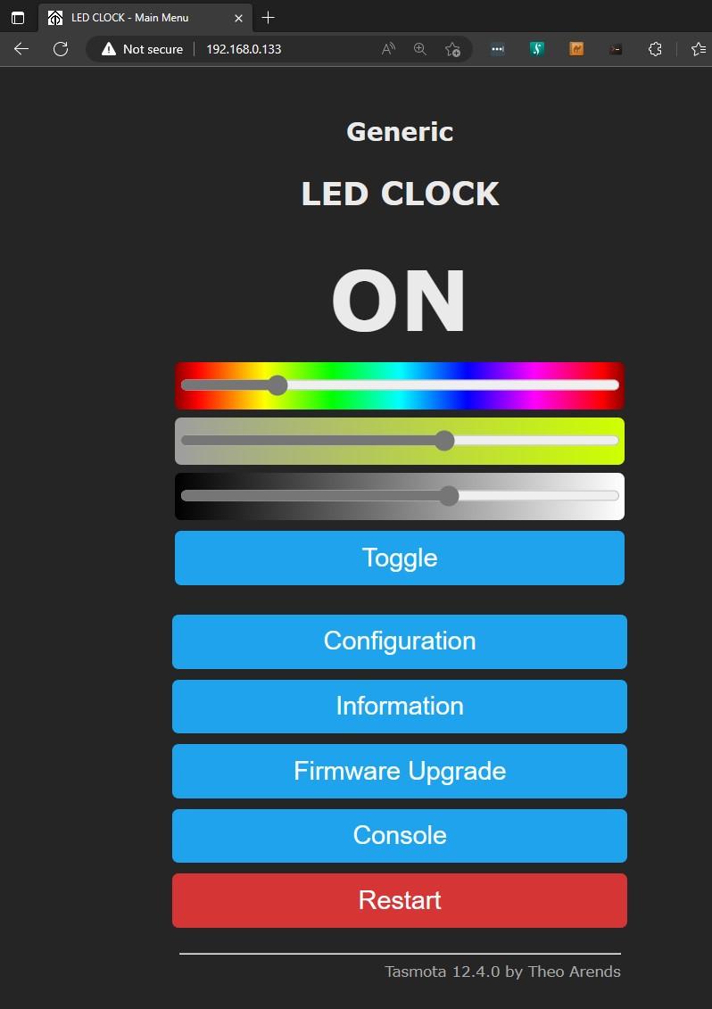

I found a really great piece of software called Tasmota which is commonly used to flash Sonoff smart switches, but can also be configured for other uses including this LED clock application. It's free and GNU open source license, easy to download and configure. The WiFi connection allows easy configuration, automatic time setting, automatic clock change in spring and autumn/fall, and easy dimming.
Loading the firmware and configuring literally takes just a few minutes - see the video! https://youtu.be/mRnswHJogKI?t=871
Find out more about Tasmota on Github: https://tasmota.github.io/docs/
Download the Tasmota Firmware with Web Installer
To download the firmware, connect a USB cable and try the online download tool:

Assuming the download went to plan it will guide you through WiFi setup, and then connect to the configuration panel.
Configure the interfaces
The key settings you'll need: (see screenshots)
  • Configuration tab: (see screenshots)
  • Configure Module:
  • Module type => Generic (18) -- This lets us use an pins on the ESP8266
  • The hit save, configure module again:
  • D5 GPIO14 => WS2812 -- This is the smart LED output for the LED ring
  • D0 GPIO16 => Led_i -- This is an inverted (active low) onboard status LED
  • Configure Wifi:
  • Add a second WiFi network if needed based on where the clock will be placed
  • Configure Other:
  • Device Name: 'LED CLOCK' -- choose any name you like!
  • Emulation:
  • Belkin Wemo -- This allows smart home devices, e.g. Alexa, to see it as a switch to turn on and off with audio commands.
  • Console:
When you click the console button it will show status information like this:

This console is where we setup the LED clock settings. Make a note of the IP address - with this you can connect to the web control interface from any device (phone, laptop etc) on your network.
Copy and paste these commands directly into the console window one by one. Scheme 5 is the LED clock mode, and pixels 60 tells it how many LEDs. Find out more about light commands here:
status 7
pixels 60
scheme 5
fade on
ledstate 6
Set width of seconds (1), minutes (3), hours (3)
width2 1
width3 3
width4 3
set color of seconds (white), minutes (green), hours (blue) using 6 digit #HEX RGB
color3 #ffffff
color4 #00ff00
color5 #0000ff
Set the spring forward DST (Daylight Savings Time) and fall back STD (Standard Time) swtichover dates. The settings below are for the UK. Find out more about timezone setting at the bottom of this section:
Timezone 99
TimeDST 0, 0, 3, 1, 1, 60
TimeSTD 0, 0, 10, 1, 1, 0
Hit restart and the LED ring should now be working as a clock! If it's not working, check through the steps above, the connection is secure and that the LED strip is powered by VIN (5v!) and NOT 3V3 (these are 5V LEDs!).
