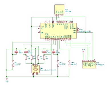

Step 1: Initial Wiring of the Encoder, Switches and OLED
  • Insert the rotary encoder, switches and OLED screen into the breadboard as shown above
  • Connect one end of each switch to ground (including the switch built into the encoder)
  • If you like you can connect the other end of each switch to ground via a 0.01uf capacitor for some rudimentary debouncing (in the image I've only done this for the 2 red switches)
  • Connect the centre terminal of the encoder to ground
  • Connect the 2 other terminals as shown in the schematic
  • Connect the OLED VCC to 5V and Gnd to ground
  • FYI. The yellow component between the red and yellow switches is a resettable fuse. I have a bad habit of shorting my circuits so I always put a fuse on the input.
Step 2: Connect the Rotary Encoder and OLED to the UNO. Upload Sketch.
  • Connect the left terminal of the encoder to the Arduino by running a wire from digital pin 4 to the junction of the leftmost resistor and capacitor. See image above and schematic
  • Do the same for the right terminal of the encoder. This connects to digital pin 5 of the Arduino.
  • Connect SDA of the OLED to A4 and SCL to A5

Step 3: Connect the Switches
  • Connect the left red switch to digital pin 2 of the Arduino
  • Connect the encoder push switch to pin 3
  • Connect the right red switch to pin 6
  • Connect the yellow switch to pin 7
  • You should now be able to change which digit is selected by using the red switches. The yellow switch changes the signal type (sine, square, triangle). The encoder button sends the changes to the AD9833 module (which of course we don't have connected yet!)
CAUTION: The output of the AD9833 is about 0.7V for the Sine and Triangle waves. However when generating a square wave the output is 5V.
Step 4: Wire Up the AD9833 Module
  • Insert the AD9833 module into the breadboard as shown above
  • Wire up the module as follows:
    • VCC to 5V
    • DGND to GND
    • SDATA to pin digital pin 11 of the Arduino
    • SCLK to pin 13
    • FSYNC to pin 10
    • AGND to GND
    • OUT is where we measure the signal (next step)
