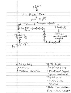

Step 2: Circuit
I wanted the circuit to be timer based so the caveman drawing is what I came up with. I also worked with alot of parts I had on hand. So basically I use a timer relay to run the ATO pump, the optical sensor triggers a 5v relay to cutoff power to the timer relay which stops the ATO pump. So it is a timed circuit that uses the optical sensor as a failsafe cutoff. On the optical sensor circuit the 4.7k resistor can be changed to increase or decrease sensitivity of the sensor. Once i had it layout on a breadboard and working I transferred the sensor circuit to perfboard.
