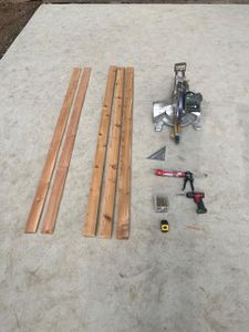

I made an outdoor adirondack chair out of cedar because I wanted to use it to go with the rest of my outdoor furniture. This is an easy way to improve and advance your woodworking and power tool skills with a fun and enjoyable project.
  1. 3 - 2x4 @ 8 feet
  2. 2 - 1x4 @ 8 feet
  3. 3 inch screws (square head)
  4. Tape measure
  5. Chop saw
  6. Pencil
  7. Impact driver (with bit that matches screws)
  8. Measuring square
  9. Wood Glue

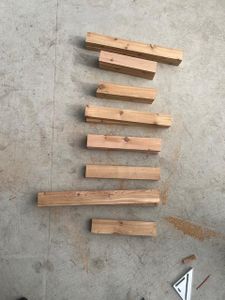

Step 2: Cut List
These are all the different sizes of cut lengths and dimensions you will need.
Make sure you have enough wood for this project before you start.
Use a chop saw to cut them.
Cut all the pieces first and then start assembling this chair.
The more precise the cuts the easier this project will be.
  1. 1 - 2x4 @ 22 inches (seat apron)
  2. 2 - 2x4 @ 33-3/4 inches (seat stringers)
  3. 1 - 2x4 @ 19 inches (seat back support)
  4. 4 - 1x4 @ 22 inches (seat boards)
  5. 2 - 2x4 @ 32 inches (back supports)
  6. 5 - 1x4 @ 19 inches (back boards)
  7. 2 - 2x4 @ 18-1/2 inches (front legs) Cut the top and bottom long point to short point 15 degrees from square. Each end must be parallel to each other
  8. 2 - 2x4 @ 26-1/4 (arm rests)

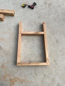

Step 3: Assemble Frame
Glue each joint before using any screws.
Attach front seat apron to the end of each seat stringer. (Use impact driver to drive in the screws)
Attach seat back support 22 inches from seat apron. (2 screws per each joint)

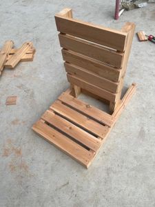

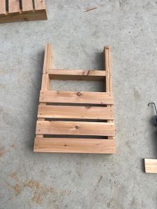

Step 4: Attach Seat Boards
Glue each board before using screws.
Attach each 1x4 @22 inches to the frame. The first board must start inline with the seat apron.
Space each board by 1 inch as you go. (Use impact driver and 2 screws per joint)
Step 5: Build Back Rest
Glue each joint before using screws.
Attach each 1x4 @ 19 inches to the back supports. (2x4 @ 32 inches)
Space each of the five boards 1 inch apart.
Make sure each board is in-line with the edge of the back supports. (2 screws per joint)
Step 6: Attach Back Support to the Frame
Glue the connection places and then use screws.
Place back support in front of the seat back support.
Attach from the backside and from the outside. (Use impact driver and 2 screws per joint)

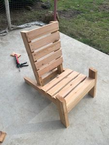

Step 7: Attach Front Legs
Glue the joints first.
Then attach the legs which are cut at 15 degrees parallel from each other.
Screw them in 9 inches up from the forward facing part of the leg. (Use impact driver and 3 screws per joint) Do this to both sides.

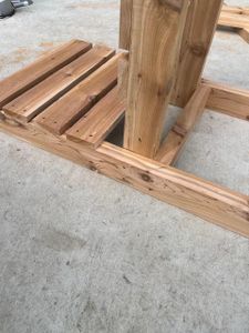

Step 8: Attach Armrests
Glue each joint then use the screws.
When attaching armrests (2x4 @ 26-1/4) make sure that the outwards facing edge of the armrests are in-line with the outside part of the front legs.
Line up the back of the armrests with the back supports. (Use impact driver and 2 screws per joint) Screw in from the top of the armrests into the front legs and from inside of the back supports.
This is the final step.
