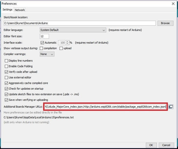

  • Now open Arduino IDE and click on File > Preferences.

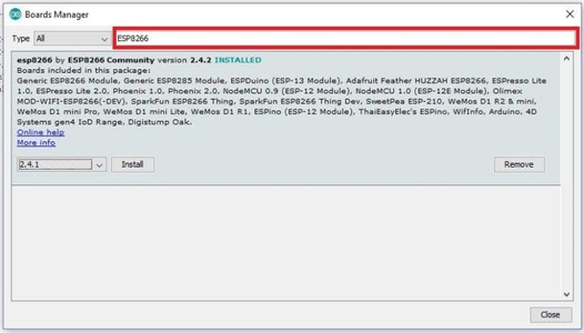

  • Type “ESP8266” on the box as shown and you will get installation option, select the latest version and click install.

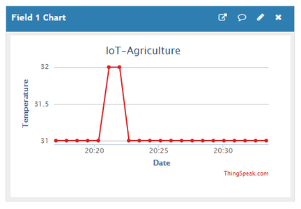

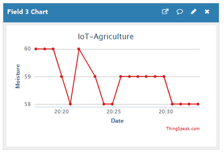

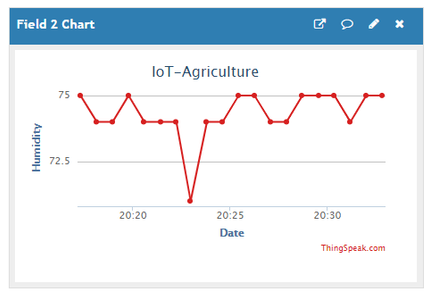

You can then see the data being displayed on ThingSpeak as well.
