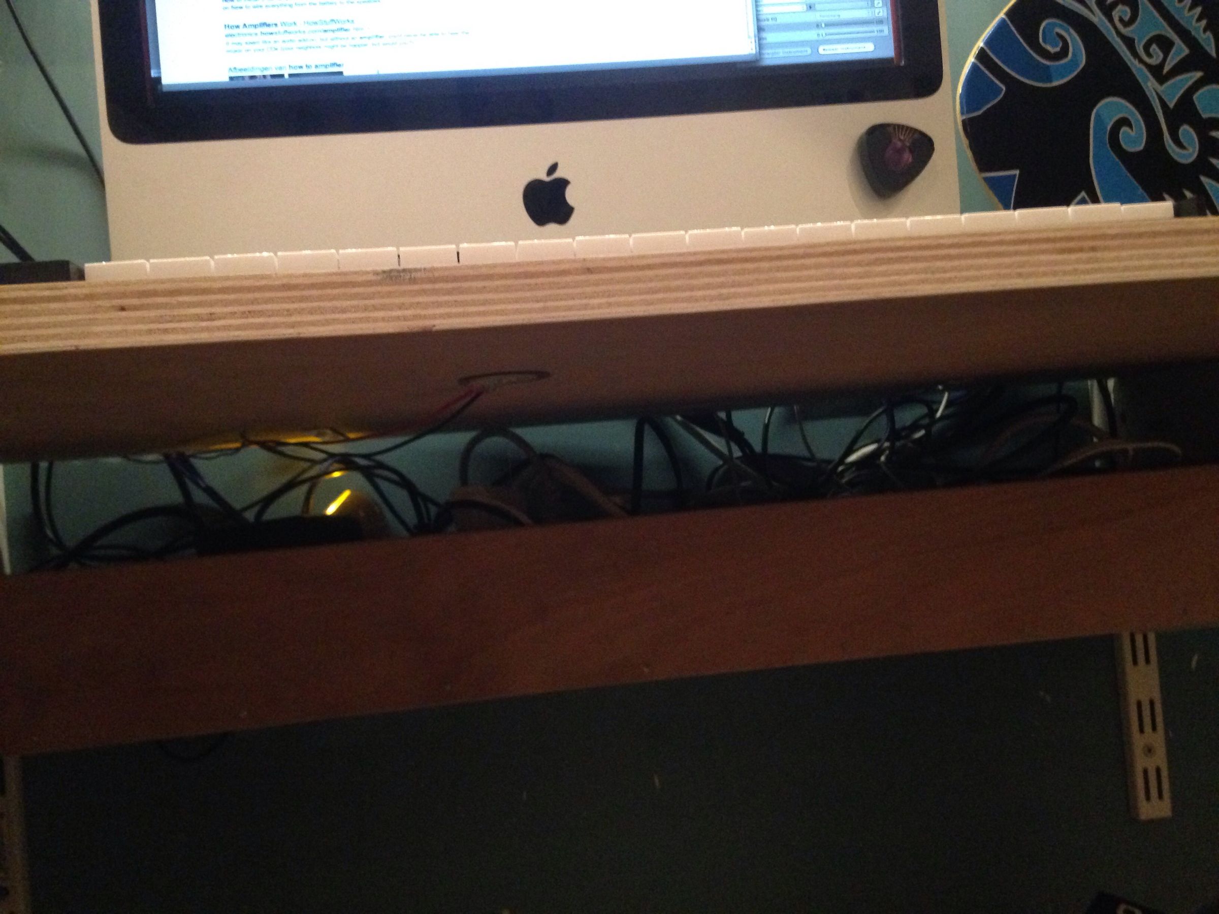

Drill the hollles and fill them up with "mounting kit" and push the pluggs in. Put the rail in place to the wall en screw the screw to the half and let it dry. After it's dried you can screw the screws as far as they can go. Now place the (big) desk top consoles in the rails and screw the desk top in place. Optional you can cat yourself two peaces of wood from 15x20 cm and mount them apart on smaller consoles so you've got yourself a cheap studio monitor stand. Now make a from two peaces of wood a L shape chest/holder for your cables and power supply under your desk and place it on two small consoles. Be sure that before you mount the desk top you've made two little holes at the side that's going to your wall for the cables. Finally you can put a LED strip above your desk for lightning at late night work in your studio.
