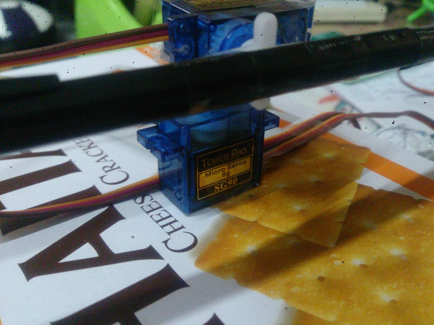

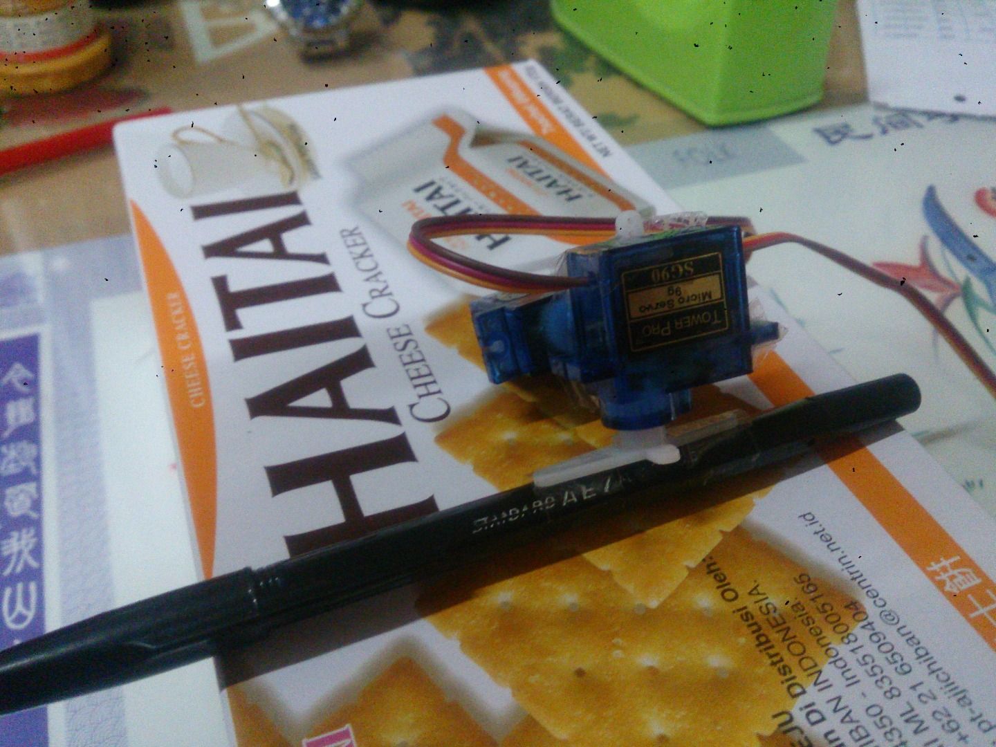

Step 1: Prepare the Arm

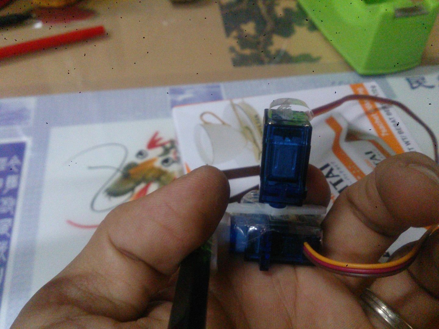

Put one side of servo body to the other servo horn. Here I use adhesive tape. Then I put a pen on the other servo horn. So the lower servo is moving left or right and the upper servo is moving upward or downward.
Then I circle a piece of adhesive tape forming double tape. and stick it on the bottom of the servo and stick the servos on a box. I also tape the servo's cables on the box.

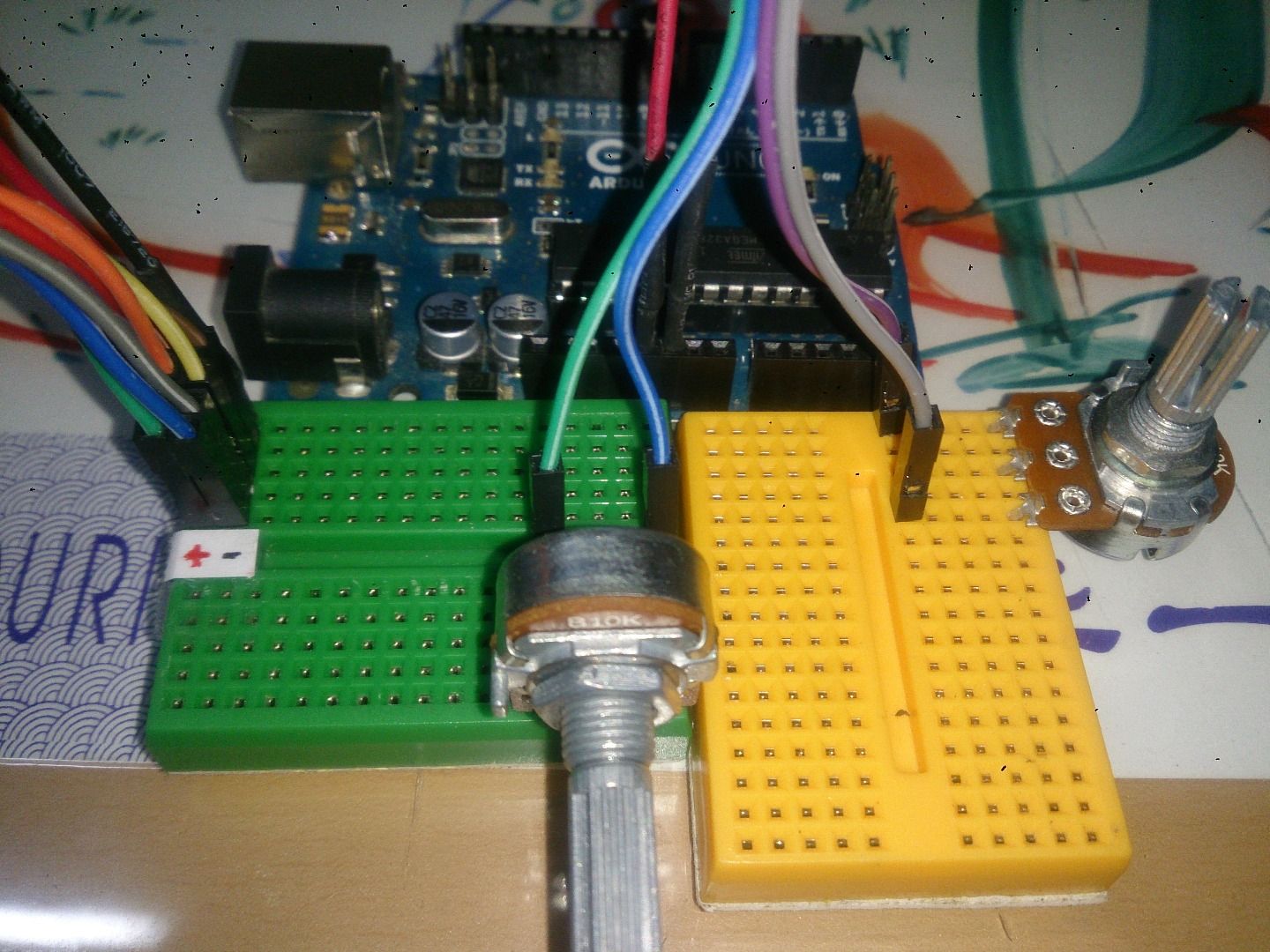

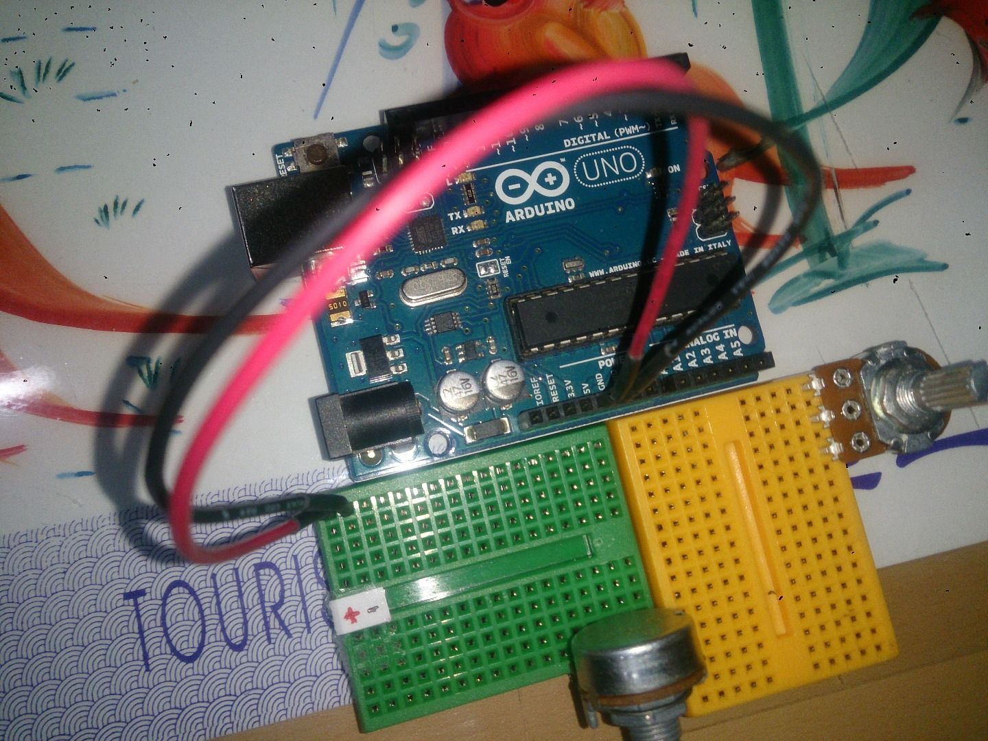

Step 2: Breadboards and Pots
I want to position the potentiometers as their function. I bend one pot so that its shaft is heading up. This one moves the Left-Right servo (LR Servo). The other one is just plugged in the breadboard. It moves the Up-Down servo (UD Servo).
Added upon publishing time : Only while writing this instructable I see that I can go on with only one breadboard, just plug the LR Pot on the opposite side and bend the pot as I have already done.. Why I don't have a vision of this earlier? Arghh.... never mind ^_^ With two tiny breadboards will be easier to describe the wiring and also easier to reach the LR Pot.

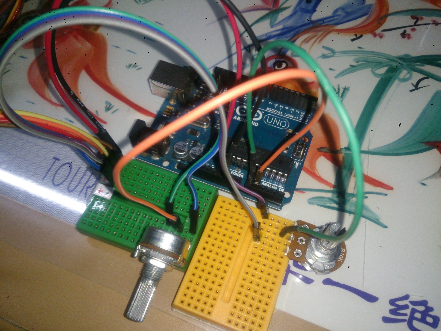

Step 3: Wiring

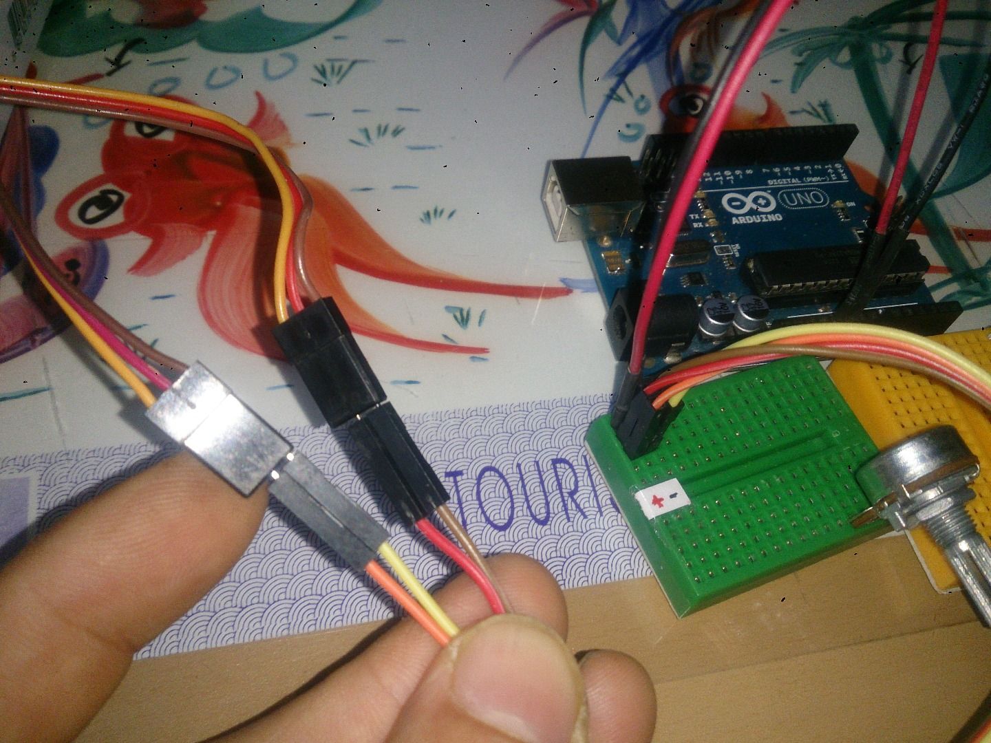

First I put power rail and ground rail on the breadboad. I marked the board with "+" for 5V and "-" for Ground so that I don't plug them the wrong way.
- Black wire from Arduino GND to Breadboard GND rail.
- Red wire from Arduino 5V to Breadbaord 5V rail.
- Red and orange wires from Breadboard 5V rail to servos' red wires.
- Brown and Yellow wires from Breadboard GND rail to servos' brown wires.

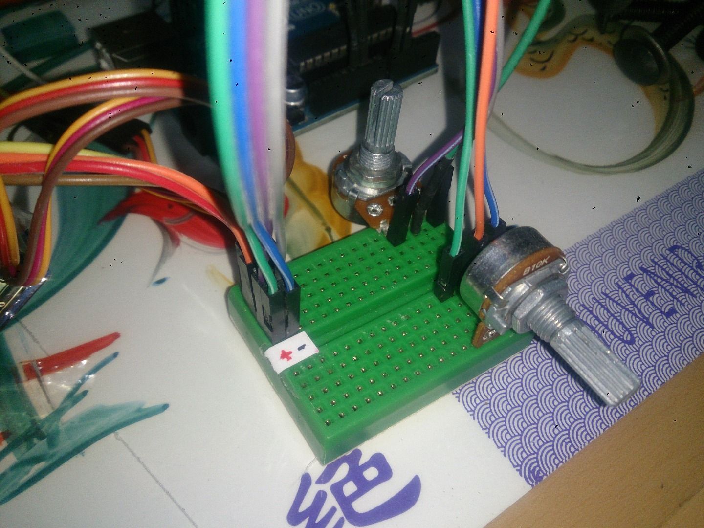

- Green and Purple wires goes from Breadboard 5V to Potentiometers left pins.
- Blue and Grey wires goes from Breadboard GND to Potentiometers right pins.

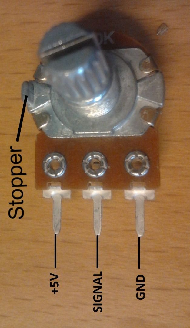

Note : There is no polarity on potentiometer pins. You can switch the 5V and GND pins with no harm. But wiring as the picture above will move the servo accordingly to your potentiometer turning direction.
- The Green wire goes from Left-Right Pot center pin to Arduino A0.
- The Orange wire goes from Up-Down Pot center pin to Arduino A1.

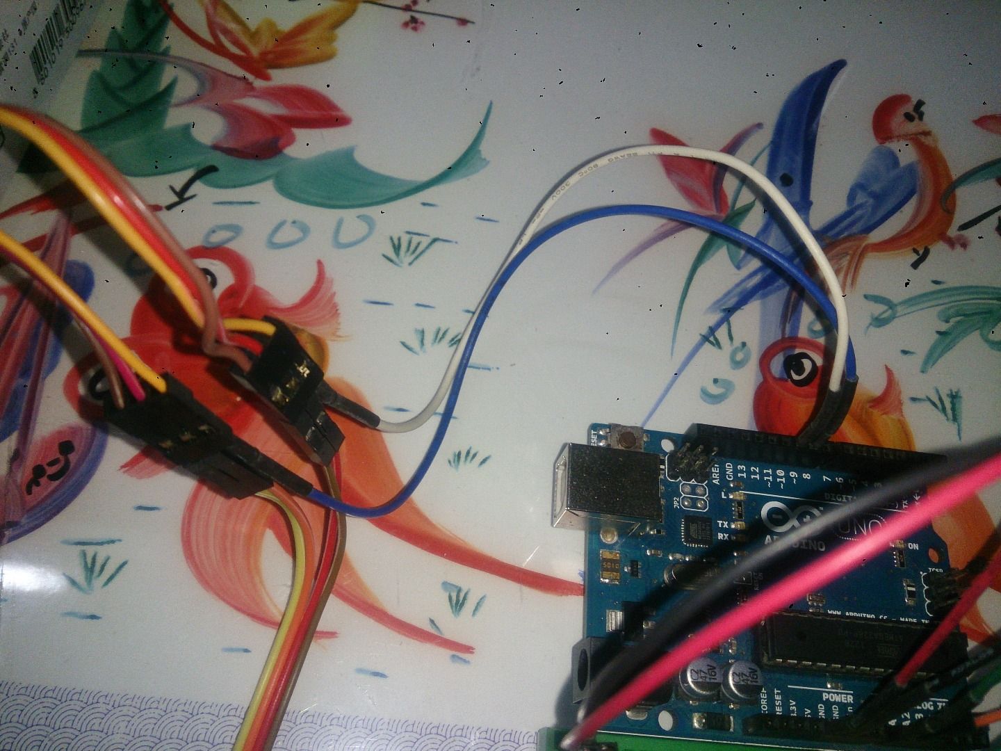

- The Blue wire goes from Left-Right Servo orange pin to Arduino D9.
- The White wire goes from Up-Down Servo orange pin to Arduino D10.
