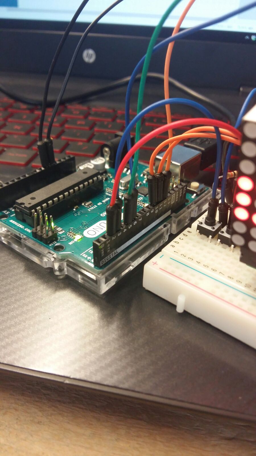

Step 1: (START PART 1) Step 1: Making the Circuit
In the image you can see the entire circuit and how it fits together.
To avoid confusion I will show you how to hook up the LED matrixes properly in the next few steps.
------WARNING-----
The Fritzing image included here says the left-most button goes into Pin(4) and the right-most button goes into Pin(3), while the left-most button should go into Pin(3) and the left-most button should go into Pin(2).

If you don't know what I'm doing in the steps described below, you can refer to the pictures.
1. Plug in the LED matrixes right next to each other and connect the VCC pins with wires and connect a wire to the (+)track on your breadboard.
2. Connect the GND pins and connect a wire to the (-)track.
3. Connect Pin(12) on your arduino to the DIN pin on the first LED matrix and from the DOUT pin on the first LED Matrix to the DIN pin on the second LED Matrix (see image for clarification)
4. Connect Pin(10) to the CS pins on your breadboard.
5. Connect Pin(11) to the CLK pins on your breadboard.
6. Connect Pin(5V) to the (+)track on your breadboard.
7. Connect Pin(GND) to the (-)track on your breadboard.
Step 3: Part 1 Done!
You have completed the circuitry for the black-jack computer!
You can download the .zip included in this step and upload the code to the arduino!
If everything was hooked in together properly according to the image the LED displays should show two 0's and change when the buttons are pressed. When you press the button in Pin(2) you add to the number and when you hit the button in Pin(3) one of the LED's should turn on and you'd see you'd passed your turn. The other light turns on then the computer hits any number higher than 17 because he's the dealer.

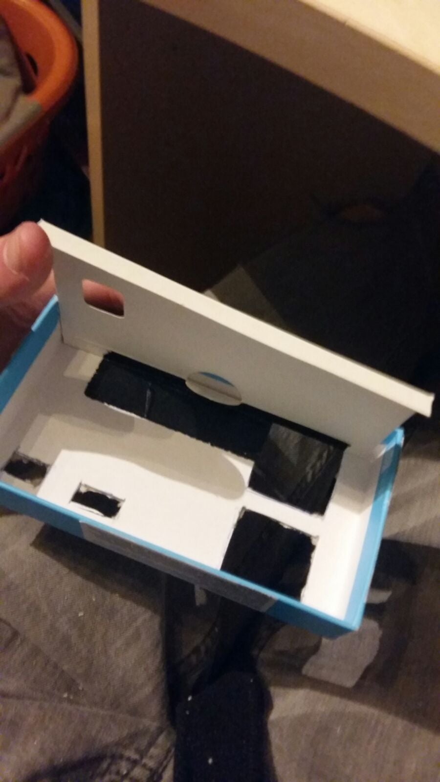

Step 4: (START PART 2) Step 1:
To follow this part of the Instructable you need the --OPTIONAL-- parts I mentioned in the beginning.
You need a knife, scissors and some duct-tape (or sticky tape) to secure some parts inside the box.
By this point you need to have soldered the curcuit together.
Step 5: Step 2:
Mark out and cut open the spots for the Matrixes, LED's, buttons and power chord. Also secure your arduino with a few pieces of ducttape on the bottom of it to prevent it moving around and to make you able to remove it laten on for further projects.
Step 6: Step 3:
Add in a platform to support your circuitry in case you don't want to ducttape your circuitry to the box.
Place in the Matrixes, LED's and buttons in their respective slots and secure them in place(either through the platform or ducttape(or both))
Step 7: Done!
