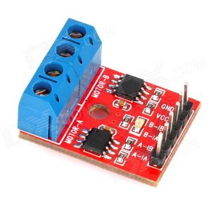

- Any motor driver. ( I am using L9110)

Motor Driver To Motors (left and right):
A1 to Left Motor -ve
B1 to Left Motor +ve
A2 to Right Motor -ve
B2 to Right Motor +ve
Motor Driver to Arduino:
VCC to 5V
GND to GND
B1 to Pin 5
A1 to Pin 9
B2 to Pin 6
A2 to Pin 3
