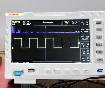

 The most important thing is to check that the shape of the signal corresponds to that of the original device designed by Hulda Clark. I will use an oscilloscope for this purpose.

 And finally, conclusion: I made and analyzed this device only from a technical point of view. It's important to note that there is limited scientific evidence to support the claims made by Hulda Clark regarding the Zapper and its effectiveness in treating diseases. Many of her claims are not based on rigorous scientific research or have been debunked by independent studies. If you are considering using a Zapper or any alternative health device, it's always advisable to consult with a qualified healthcare professional who can provide evidence-based advice and guidance.
