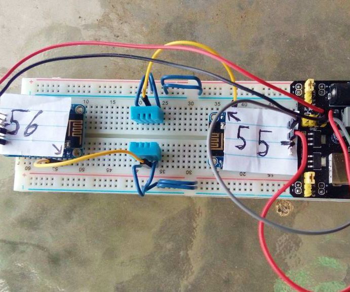

As you can see from the pictures above, I simply soldered a 10k resistor to one leg of a photocell and bent it in a way that allows it to be plugged correctly into the Arduino, bypassing the need for a bread board. I did notice that occasionally a contact would be loose and the reading in the serial monitor would stick at 1024 but if you just jiggle the contraption a round slightly to make sure that all the contact points are touching correctly would fix that issue.

So, it's really simple. Solder one leg of the resistor to one leg of the photocell. Are you decent at soldering? Then you're almost done. After it cools bend the resistor so that the unattached end can reach the ground pin on the board. I had to bend mine back toward the other leg of the photocell since 5V and Ground are next to each other. Be careful that when you bend it you don't let it touch the other leg (A0) of the photocell and short it out (well, not short it out, but you won't get any readings and you'll be scratching your head wondering why).
To connect it to the board, the un-soldered leg of the photocell goes into the 5V pin, the un-soldered leg of the resistor goes into the Ground pin and the other leg of the photocell (the soldered one) goes into pin A0.
