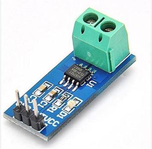

The current sensor module utilizing hall-effect principle which voltage is produced from the movement of current within the region of magnetic field. The voltage produced by hall effect is directly proportional to the applied current making it suitable to estimate the applied current from the voltage sensed.

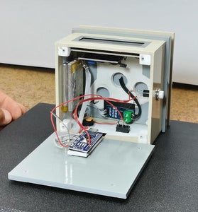

The device is extremely simple to make and consists of only a few components:
- Arduino Nano microcontroller board
- Solar Cell (preferably with a voltage of 0.5V and a short-circuit current of 0.5 to 1 A) - If we do not have information about this value from the manufacturer, we can determine it with the following procedure: We connect the solar cell directly to the ammeter, and point it in the direction of the sun so that the light falls on it at an angle of 90 degrees. The current that is read at this moment is called Short circuit current. Then this value is entered into the code.
- ACS712 Current Sensor Module rated at 5A
- 16x2 LCD Display with I2C communication protocol
- Button
- and two resistors

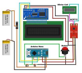

The sensor is connected to the solar cell with relatively thick and short wires to avoid interference and losses. The voltage output of the board is connected to the power supply and the A1 analog input of the Arduino.

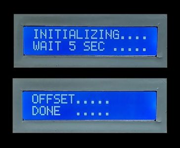

Immediately after turning on the device, we need to cover the sensor and press the button, and after that, initialization and calibration of the sensor takes place, which lasts about 5 seconds, then the message "OFFSET DONE" appears briefly, so next we direct the cell towards the sun. Now, I will use this Lamp instead of Sun.
After that, the data obtained from the measurement is displayed:
- The first row shows the amount of current generated by the panel, and the current power delivered by a panel with an area of ​​1 square meter.
- The second row shows us how many Watt-hours are generated from the beginning, until the moment of reading.

Step 4: Conclusion, Schematic, and Code
And finally a short conclusion.
This is a very cheap and simple to make, but extremely useful instrument, especially when designing such systems to simulate and provide feasibility study of a location or site whether it is viable to install Solar PhotoVoltage System.
