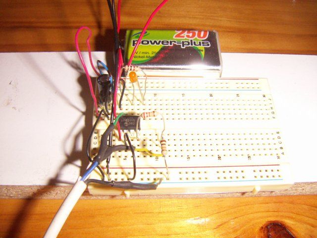

The 20x4 display is configures for I2C communications as this only uses two arduino pins. The I2C module can be purchased separately or it is possible to buy 20x4 displays with the module already attached (search 20x4 lcd I2C).
The APC220 module comes with its own antenna that has a range of about 500m through trees. It is possible to replace the coiled antenna with a straight piece of wire 17.3mm long and this extends the range another 20%. It is also possible to add a ground wire of 17.3mm and this creates a dipole of 34.6mm and this extends the range another 20%. The dipole is mounted vertically for an omnidirectional pattern.
For reading analog voltages, the arduino inputs are more stable if a 10uF capacitor is placed across the inputs at the board.

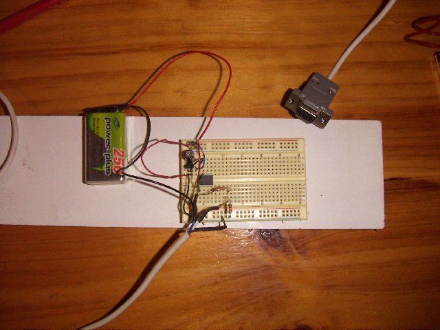

The APC modules come with a little USB programmer and this can be used to change the frequency and the baud rate. If you run the utility program, for some reason windows needs you to right click and "run as administrator". The default options though are fine, ie 433Mhz and 9600 baud.
In the photo above is a little RS232 module. I've got this connected to pin
