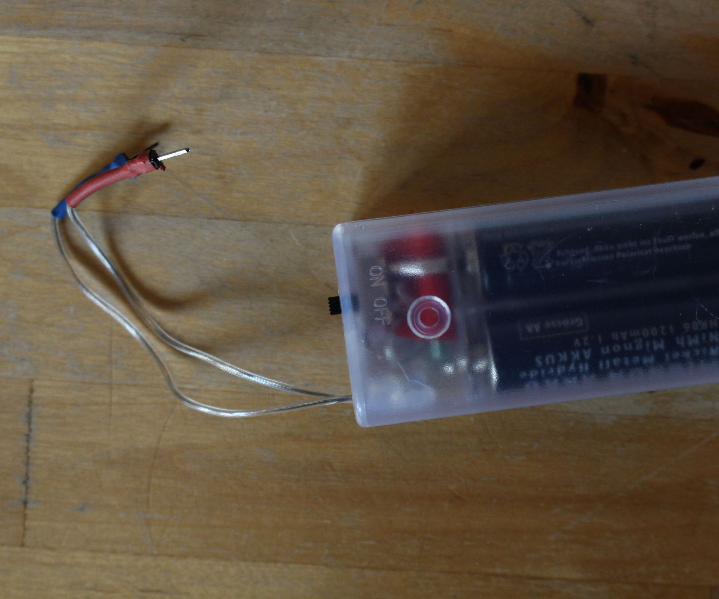

Step 6: Powering Your Ergometer Display
There are many ways to power your display, but I'll point out two which seem rather more practical than others:
- When using an Arduino Uno or Nano, you probably want to power it using a USB power-bank with built-in low battery indication.
- When using an Arduino Pro Mini @ 3.3V (my recommendation for advanced users), you can power that directly from either a single LiPo battery, or three NiMH cells. As the ATMEGA will tolerate supply voltages up to 5.5V, you can connect this to "VCC/ACC", directly, bypassing the on-board voltage regulator. In this setup, there will also be a "low battery" warning at around 3.4V, without any additional hardware (displayed in the lower right corner). As the ATMEGA can be expected to work correctly, at least down to 3.0V or so, that should leave you enough time to finish your training unit before recharging.
