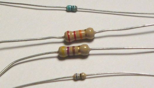

* Resistance 10 Ohm [ 0.25Watt ]

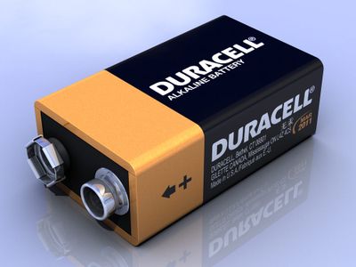

* 9v Battery or a 9v DC power jack (female jack)

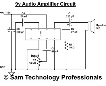

So have a look of its schematic
Step 2: Circuit Diagram:
Here is its schematics and i hope that every thing is clear in it. But if you have any question you are free to ask me here. I promise to give your every question's answer.

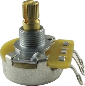

Control the output gain with 10k Potentiometer (I will prefer an audio pot not linear pot - but you can use linear too)

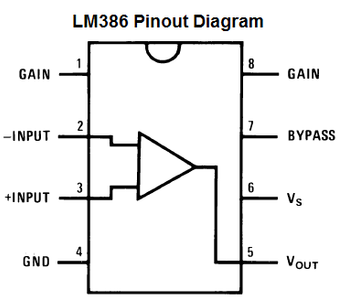

You can see that 1-8 points of the IC isn't connected. You can connect them with each other by putting a capacitor.
Want to change the sound..??? Remove the capacitor 100nf from 7th pin of IC and from GND. Then put the capacitor 10uf between 1st pin and 8th pin. Then observe the output gain. You can change the value of the capacitor 10uf to set the type of output.
