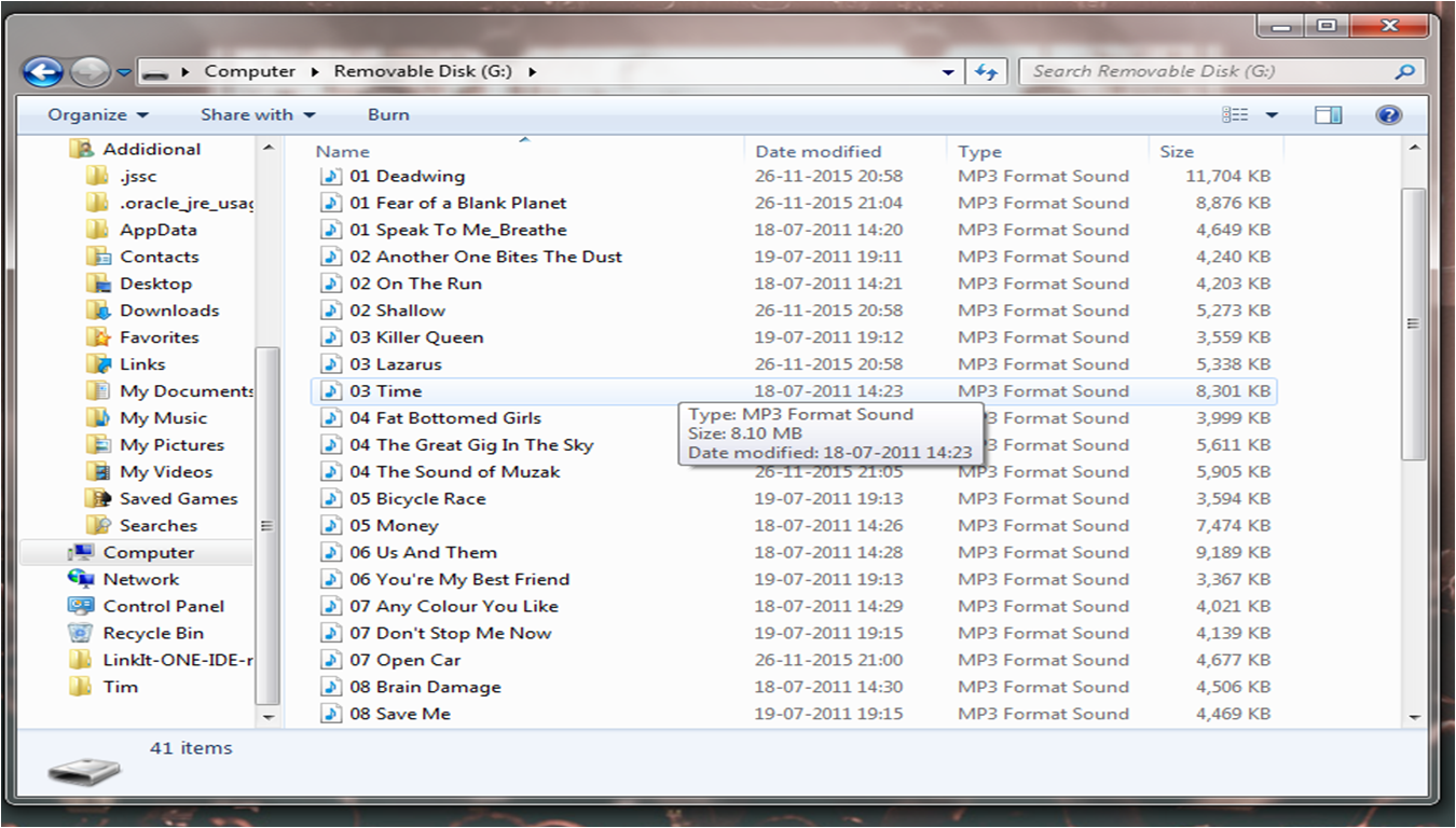

Step 5: Add Songs to a MicroSD Card...
Convert The Songs to .mp3, .wav, or .aac (if it isn't already)
- Download an audio converter (like Media Human converter)
- Select songs to convert
- Convert songs to .mp3 (constant bitrate), .wav (though this creates HUGE files), or .aac (recommended, best sound quality)
Transfer songs to SD card:
Make sure all the songs aren't in a folder.
