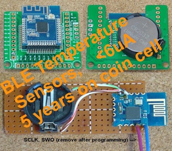

There are only two components:- A nRF52832 'bare' module and a coin cell (in a holder).
The following nRF52832 'bare' modules available from Aliexpress can be used. They include:-
GT832E_01 ~US$15.90 mounts on vero board

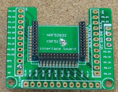

Jessinie XL52832-D01 nRF52832 module ~US4.90 and Jessinie Test Board Adapter Plate for NRF52832 ~US$1.70 – Total ~US$5.60
BLM-KTB522 ~US$6.30 (no crystal) pin for pin replacement for Skylab SKB369, needs to be mounted on PCB
Those 'bare' nRF52832 do not have any extra components or power regulators that will used extra current.
Add to this a CR2032 coin cell and holder, e.g. Sparkfun coin cell holder PRT-00783 US$1.60 and CR2032 coin cell PRT-00338 ~US$2.10 – Total US$3.70
So using the Jessinie module and adapter and a coin cell and holder the total cost (excluding shipping) is < US$10

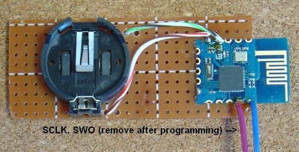

Step 1: Construction

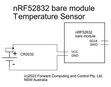

The schematic is trivial. Coin cell +ve goes to VCC and coin cell -ve goes to GND on the nRF52832 module. The SCK / SWD connections are used for programming.
For the Jessinie module and adapter board the coin cell is mounted on the back of the adapter board.
Drill a small hole (1mm) in the adapter board to accept the -ve pin of the coin cell holder when the +ve pin is in the VCC hole on the edge connector. See the photo below. The +ve coin cell pin is soldered into the VCC hole, the bottom left in the first photo, and the 1mm hole has been drilled in the earth plane and the green lacer scratched away to solder the coin cell holder's -ve pin.
For the GT832E_01 as small piece of veroboard is used to mount the coin cell and the module. Wires from the bottom of the veroboard to the GT832E_01 edge contacts for VCC / GND and SCK / SWD (used for programming) hold the BLE module in place.
The BLM-KTB522 module needs PCB to mount it. Since it is a pin for pin replacement for the Skylab SKB369 module the PCB from the Easy Very Low Power BLE (2019) in Arduino Part 3 - Nano V2 Replacement can be used, but omitting all the additional components and voltage regulator and dual diodes with wire links to connect the coin cell directly to the BLM-KTB522 module.

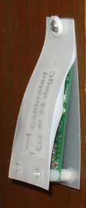

Step 2: Cases
Having assembled the two components, you may want to add some dust protection as shown here, allowing free air flow around the nRF52832 chip.
In the first example above just strips of plastic were used as the case and the temperature monitor was screwed to the side if a book case to monitor the room temperature.

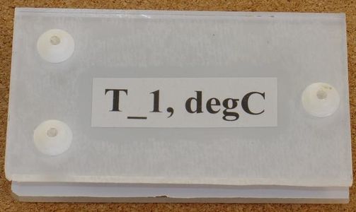

In the second example above, two small panels of 3mm perspex were used for a more sturdier mounting case that can be left lying around the desk.
Again all sides are open to allow free air flow around the nRF52832 chip and an opaque book covering plastic is used to cut down heat pickup from sunlight. A top layer of reflective kitchen foil was added as well.
Each temperature monitor was labelled with its short name, so it could be associated with its scan data.

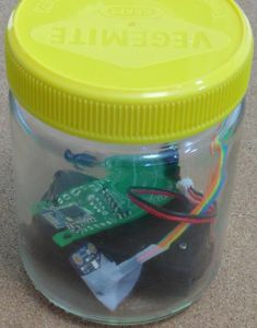

Where the sensor is placed in the water proof jar in the water. For low temperatures, it is placed in the freezer to freeze the water. For high temperatures, near boiling water is used. In both cases the bath is wrapped in towels and or bubble wrap to slow down the temperature change so that the uC has time to stabilize at each temperature measured.
For this calibration it is convenient to add a more accurate temperature sensor to the circuit and to advertise both readings.
Here a KTMB522 (a SKB369 pin for pin replacement) is being calibrated using a Si7021 and a PCB from Easy Very Low Power BLE in Arduino (2019) Part 3 - Nano V2 Replacement. On that PCB SDA is connected to P0.28 and SCL connected to P0.31 which are different from the programmed default of SDA - P0.09 and SCL – P0.10, so Wire.setPins(28,31); is called before calling Wire.begin(); to set SDA as P0.28 and SCL as P0.31.
The KTMB522 does not have low frequency 32Khz crystal, so you need to program it using the Generic nRF52832 (LFC RC osc) board setting.

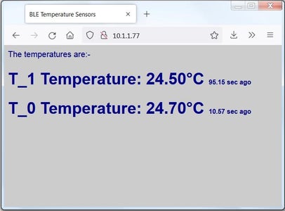

Step 7: Web Page Temperature Display and PfodDevice and Temperature Plots
There are lots of ways you could use the ESP to make your temperature measurements available over WiFi, for example using MQTT, here two simple examples are provided :-
1) The first one just makes the latest measurement available on a webpage.
2) The second uses pfodApp on an Android mobile to display the latest measurement and a plot of the last 24hrs temperatures with day and time. No Android programming is required and the plot data can be save to a file for further processing. The free pfodDesigner app generates the pfodApp server/menu/plot code for you.
The example is based on the ESP8266 example code from ESP32 / ESP8266 Auto WiFi Config and displays just a simple text web page. It is left as an exercise to the reader to create a 'pretty' webpage display.
The example web page sketch is in BLE2WiFi_ESP8266Web_example.zip Unzip it to your Arduino Sketch directory.
Download this library zip file, ESPAutoWiFiConfig.zip, and install it using the Sketch → Include Library → Add .ZIP File menu in the Arduino IDE . You also need to install the SafeString library V4.1.19+ from the Arduino library manager.
This sketch, BLE2WiFi_ESP8266Web_example.ino, first tries to connect to a local router. If it cannot it starts its own access point called WiFiConfig with a password of 12345678 and serves a network configuration webpage at 192.168.1.1 for you to set your network's SSID and password and also set the static IP (10.1.1.77 in the example above) that you will connect to to display the temperatures. See ESP32 / ESP8266 Auto WiFi Config for more details
