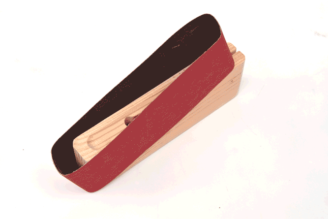

Handheld sanding blocks are a must for every woodworker. They allow you to easily hold sandpaper, remove unwanted material, and smooth projects. There are many commercially available sanding blocks, but these sanding blocks can be made quickly from scrap 2x4s and spare dowels. The block is split for about three-quarters of its length, and the belt is tensioned with a removable dowel.

Cut an 1/8 inch wide slot through the dowel pin hole to the relief hole. This will bisect the sanding block and cause it to separate with the insertion of the dowel pin.
Step 8: Cut Dowel Pin
Cut 3/8 inch dowel to 3 inches in length. Sand a bevel on one end. Slide the sandpaper belt around the block. It should be mostly tight while sliding over the block. If it does not fit, cut a little more off the end of the block, re route the ends of the block and repeat as necessary until the sandpaper fits. If the sandpaper is loose, cut a new dowel pin with a larger diameter until sandpaper is tight.

Cut 1/4 inch dowel to 3 inches in length. Sand a bevel on one end. Slide the sandpaper belt around the block. It should be mostly tight while sliding over the block. If it does not fit, cut a little more off the square end of the block, re route the ends of the block and repeat as necessary until the sandpaper fits. If the sandpaper is loose, cut a new dowel pin with a larger diameter until sandpaper is tight.
