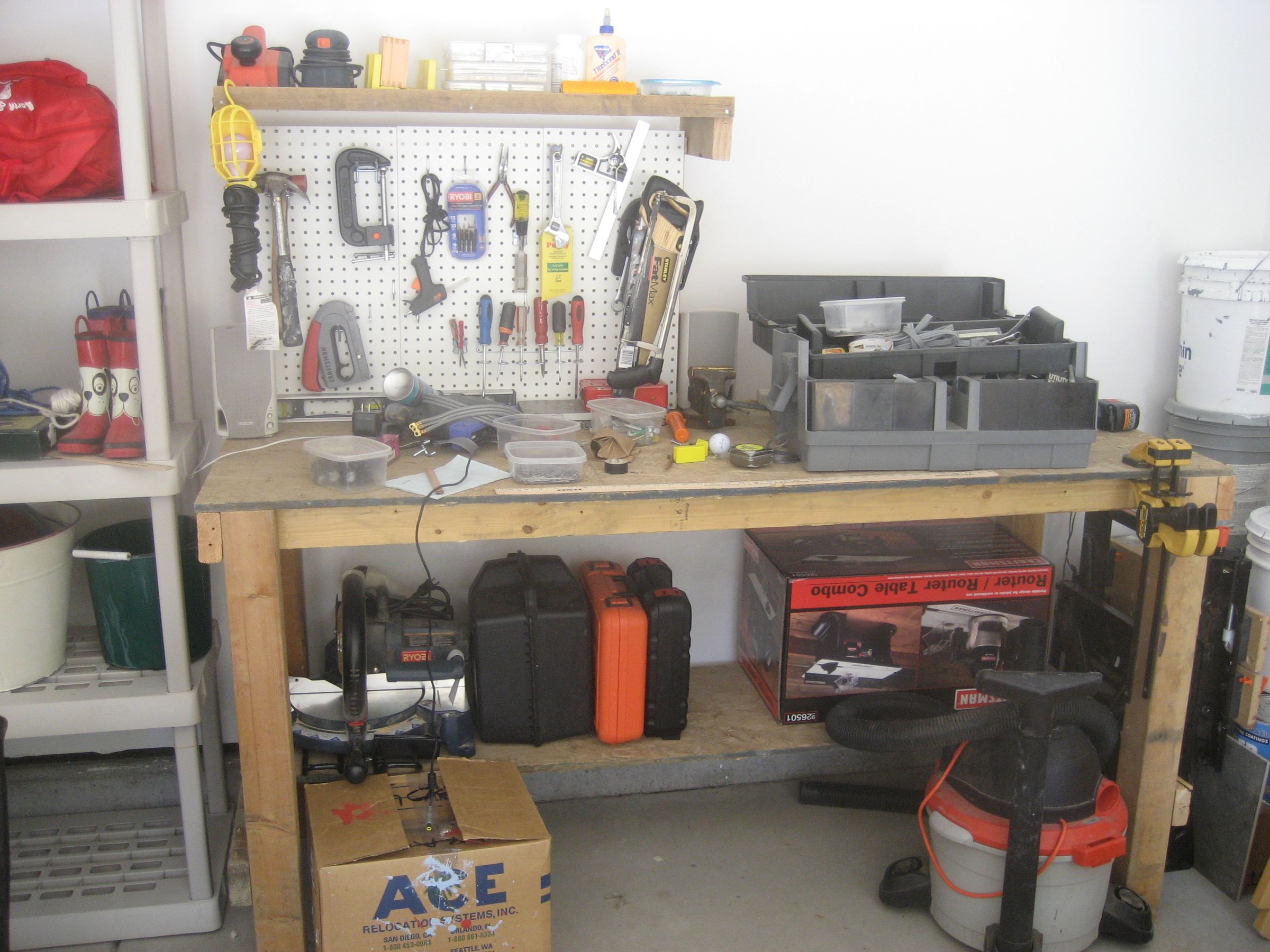

You probably need some tools. Here is what I used:
1 - Table Router - If you have this, you can find another Instructable now. I assume if you have a table router, you don't need this.
1 - Circular saw - You can use a hand saw, but I prefer the circular for ripping things quickly. If you have a hand saw, you might want to think about Ikea. Another option, if you are really hard up for tools is to draw it out and have the lumber yard make the cuts for you. Mine does it for a dollar a cut. Then you can just assemble
1 - Miter Saw - See my description of a router. You can buy the box and a saw for about $20. Having a miter saw is always something good to have and you can get a decent one for about $150.
1 - Power Drill with screw bit attachment
1 - Counter sink drill bit - This isn't necessary, but it makes the holes pretty clean and provides for good pilots.
