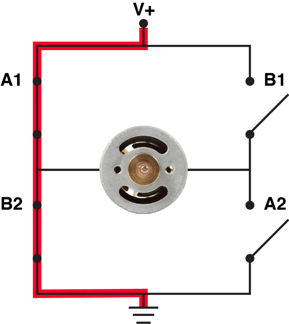

An H-bridge is a circuit that allows a motor's direction to be reversed. More advanced H-bridges - like the kind found inside of servo motors - also allow you to control the speed of the motor.
Essentially, an H-bridge consists of four switches. There is a switch between each pole of the motor and ground. There is also another set of switches between each pole of the motor and power.
When these switches are drawn out in a diagram, they look kind of like an “H”. That is how the circuit gets the name H-bridge.

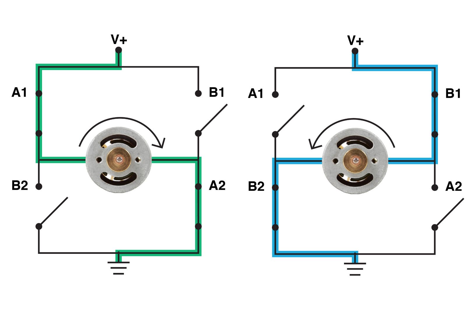

The H-bridge consists of two sets of switches. When the set of switches labeled with “A” is closed, power flows through the motor in such a way that it spins clockwise.
When the other “B” set is closed, power flows the opposite direction and the motor spins counterclockwise.
However, both sets cannot be closed at the same time, or power and ground will be directly connected, and you will have a short circuit.
As well, if you mix and match the switches such as closing A1 and B2, you will also create a short circuit. It is important that either the “A” switches get closed or the “B” switches. Never both or some combination thereof.

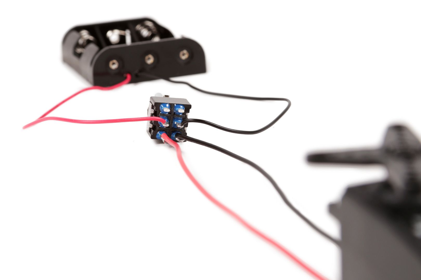

WIth a DPDT switch you can make the most basic H-bridge imaginable.
Basically, if wired correctly, a motor connected to the switch will spin in one direction when toggled one way, and the opposite direction when toggled the other.
To begin wiring this, solder the red wire from a 3 X AA battery holder to one of the center pins on the DPDT switch and the black wire to the other center pin.
Select one of the pairs of outer pins. Solder a red motor wire to the switch terminal in line with the center pin with the red wire already attached. Next, solder a black motor wire to the other outer pin.
Now, when the switch is toggled, the motor is either powered by the battery pack and spinning clockwise or doing nothing at all. We are halfway there. All we need to do is have the motor change direction when it is in what is currently the 'off' position.

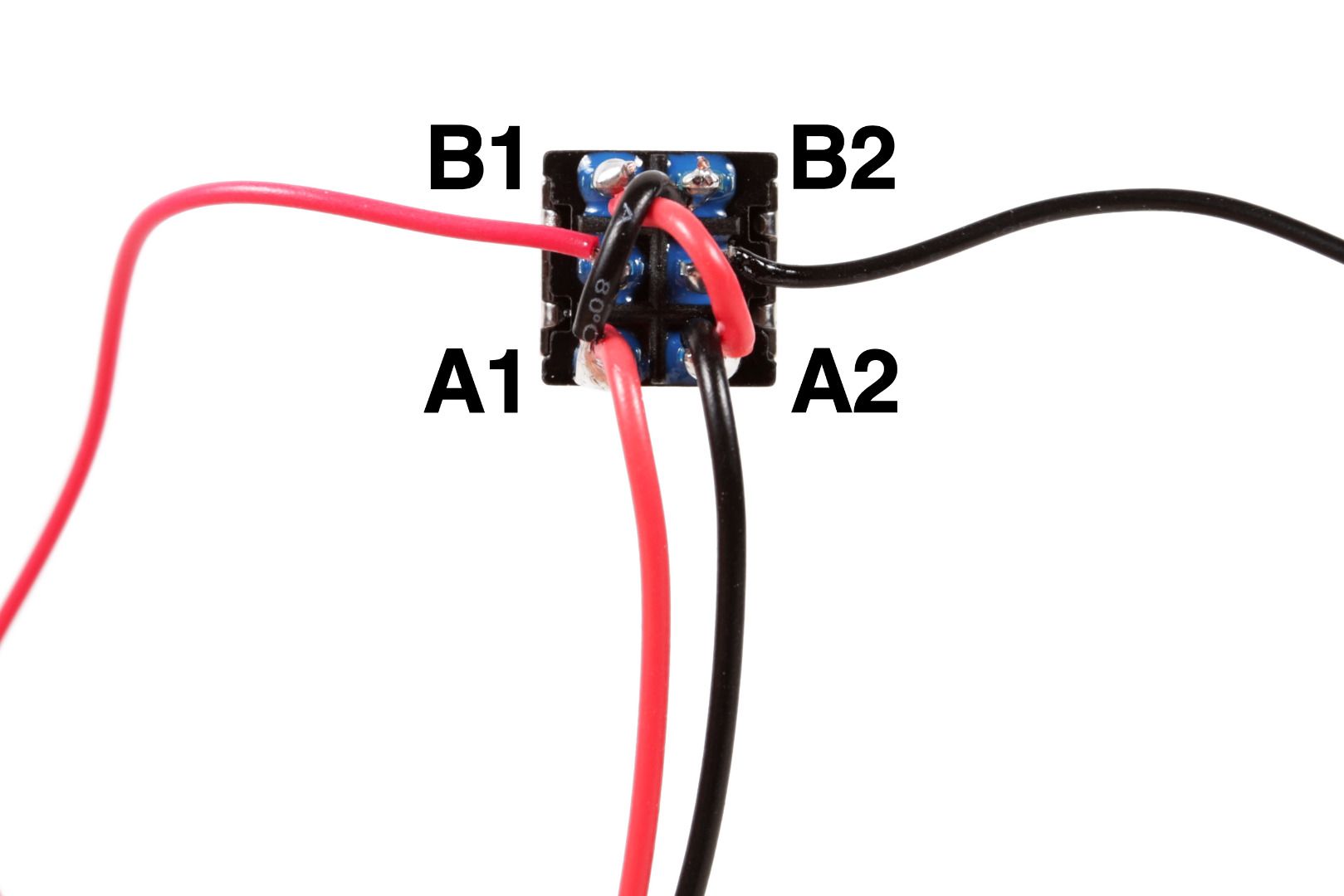

To accomplish this, we need to wire it in such a way as to reverse the power to the motor. This may seem complicated, but is really easy. All we need to do is connect criss cross wires from the unused set of switch terminals to the terminals connected to the motor.
Basically, when the switch is toggled to make this connection, the black wire from the the battery pack is connected to the red wire from the motor, and the red wire from the battery pack gets connected to the black wire from the motor. By crisscrossing the wires, we have effectively reversed the power supply to the motor.
In this configuration, the H-bridge A1 and A2 connections are the first set of terminals connected directly to the motor. The B1 and B2 connections on the H-bridge are the other outer terminals where the crisscross wires are connected when the switch is flipped.
