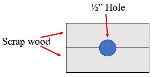

You will need some way to secure the dowel to your work surface. I do not have a bench vise, so I improvised with a makeshift dowel-holding jig (see last picture).
