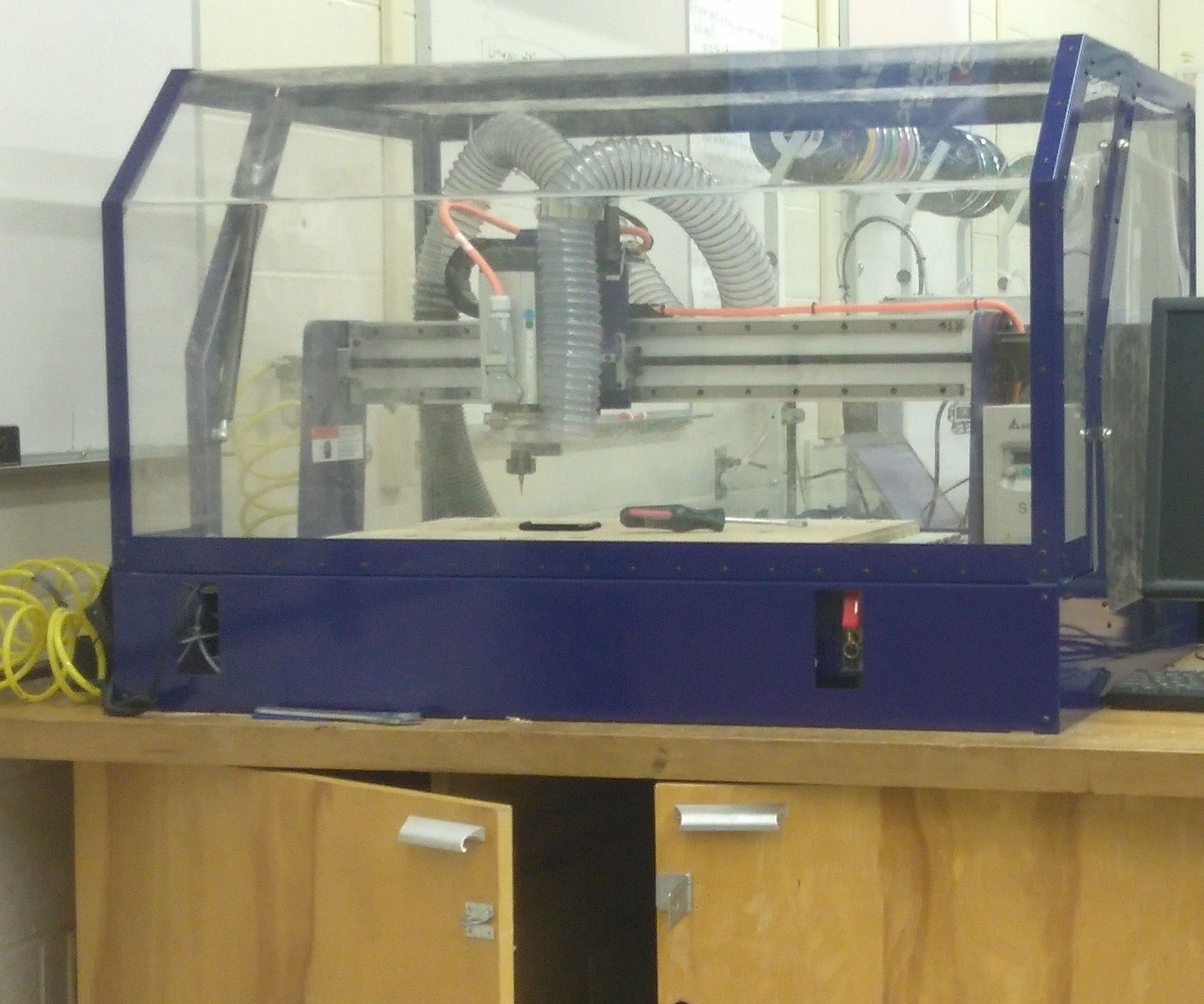

Step 5: CNC Machine Start Up
1. Place the drill bit in a central location on your cutting surface to ensure the machine is not on any limits before it is turned on.
2. Turn the machine on, the switch is located on the back.
3. If the LED light reads "2" then you are on a limit, if it reads "0" then you are not on any limits.
4. Open the "Techno GCODE interface" click the jog button. You now van control your CNC machine.
