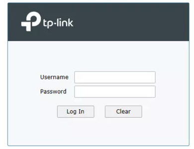

Step 3: Login to Your ER605
LOGIN TO YOUR ER605
*enter your username and password which entered while first setting up you device
*make sure its running latest firmware (you can install latest firmware by going to tplink downloads website)
*********caution you need to update your tplink firmware step wise or else it might brick your device ***********
