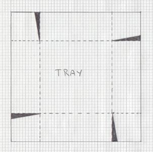

I'm making a 5cm square tray that's 2cm high, so I'll need a 9cm by 9cm piece of card. You'll need to mark it out for cutting like in the diagram above. From each corner, measure 2cm up both sides, and mark the spot with your pencil. Then take your ruler and match up the marks on either side. Holding the ruler firmly in place, take your scoring tool and then run it firmly along the edge of the ruler to join the marks with a dent in the card.
You can draw lines with your pencil and then fold it carefully without scoring, but scoring does give you a neater and easier line to fold.
With your scissors, snip one line along the corner on each side. Doesn't matter which, as long as you stick to the same one when rotating the card to cut the next. Then carefully snip out a little triangle on the smaller section so that when you fold your box together and glue it, it doesn't get pushed out of shape by any oddly cut bits of card on the bottom edge of the flap.
Fold everything inwards on the score lines to form a tray shape with the flaps hanging out - they should have a little give and want to go in the direction you're pushing them to make it easier. Then dab a little glue on the flaps and stick them to the walls inside the tray.
Set aside your tray and let the glue dry - it shouldn't take long as it's a tiny amount on card.

The simple tray is fine if you're wanting to display some jewellery or a badge or throw a chocolate in there. But if you want it to store things - perhaps paper clips, spare screws, that kind of thing - you might want a bit of extra security on the edges that come out of the sleeve so things don't slip out so easily. This is really easy to do, and you don't need to make any changes to the sleeve dimensions, just the tray. If you look at the diagram above, you just need to add 1cm to 2 of the opposite ends of the tray. So for my 5cm x 5cm x 2cm tray, rather than needing a square of card that measures 9cm x 9cm, I'll need one that measures 9cm by 11cm, which accounts for making the extra flaps. Then follow the same process for the regular tray, but mark out the extra two flaps and cut the extra card away accordingly, then fold them inwards so they provide an extra barrier to prevent things slipping out of the gap between the sleeve and the tray.
Be sure to add these flaps to the sides that will be sliding in and out of the sleeve. This doesn't matter on a square box, as all sides will fit. But if you make a rectangle box, you want to make sure your flaps will be where you need them.
