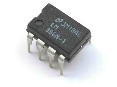

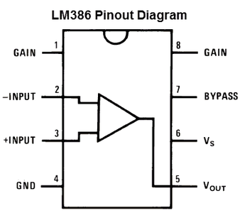

* IC LM386 (audio amplifier)

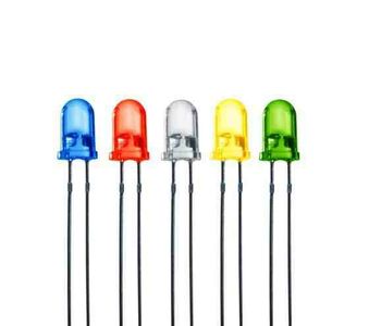

* LED (colour of your choice)

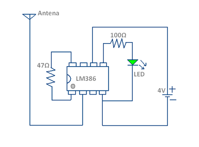

Step 2: Make Connections

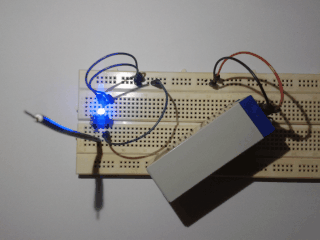

Use breadboard for testing this circuit. Make connections as per the diagram given.
This instructable is made with the ic lm386 as it's heart with only few other parts.
Don't use supply more than 5V. It will make led bright continuosly taking you out from indication.
Step 3: Operation
The antena is to reveive signals. The big is the antena the greater is the receiving area.
Just keep your device near it(upto 1meter for 7inch antena) and Done !!
As signal get detected by it,the LED will start blinking according to that giving you information about that perticular action.
