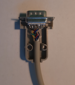

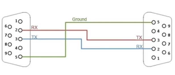

Step 2: Preparations
DB2 cable wires need to be changed in order to have a correct transmission of data. Cable need to be converted to a Null Modem cable. This is accomplished by changing the RxD pin wire with TxD pin wire at one end of the cable as it shown in the picture.
The rest of the DB9 control wires are not needed so they can be discarded.

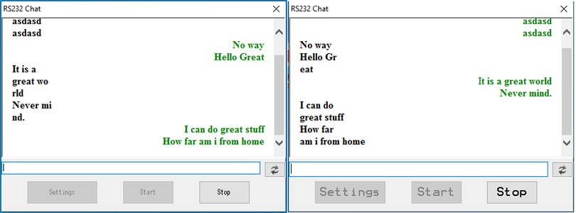

Step 4: Communication
Start the RS232Client.exe on 2 separate computers. Settings are hard codded to match those in firmware.
Typing text in one client will appear on the screen of the other client. Communication is asynchronous which accounts for receiving a line of text in small chunks and showing them on UI side on different lines in the text component. This could be fixed by gathering text in a buffer and showing text as a whole line when End of Line(0x10) character is encountered.
