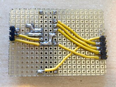

Step 3: Build Your ATmega328 Programmer Shield
ATmega328P Pin Mapping > Arduino
1 > 10
7 > VCC
8 > GND
9 > Crystal > Capacitor1 > GND
10 > Crystal > Capacitor2 > GND
17 > 11
18 > 12
19 > 13
20 > VCC
22 > GND

EkDor
EkDor
Question 11 months ago on Step 3
It looks like in your last photo the pins are in the wrong sockets. Is this correct.
0
RomeroDIY
RomeroDIY
Answer 11 months ago
It works for me. The photo must be deceiving. If you follow the pin mapping it should work for you too.
