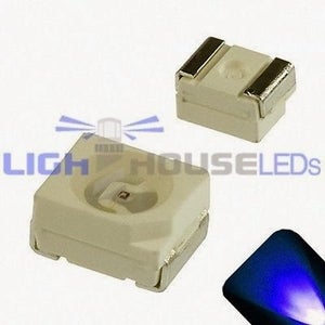

- 10xBlue SMD LEDs (specific one in the pictures)

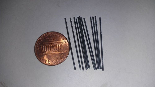

After, drill holes with a dremel rotary drill.

Recently, all my drill bits have been breaking like crazy. This really put a damper on my projects. I bought a bunch of new drill bits and I reccomend steel drill bits. They drill extremely quickly.
I'm not sure if this link will work in the next week, month, or year, but here it is.
After drilling, sand out the edges.
After sanding, prepare tweezers and your LEDs.
For these LEDs, the side with the notch is the negative end.
