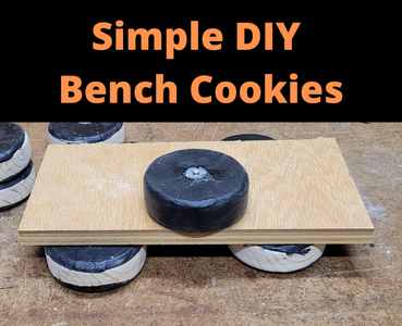

I've been bombarded with e-mails from Rockler Woodworking to buy their bench cookies and decided it was a great time to get in on the Rigs and Jigs Contest. Overall you can make your own bench cookies for a fraction of the cost, and nearly for free using scrap wood. Check out this instructable for a great substitute DIY option to purchasing these outright.

Step 1: Mark and Drill Pilot Hole
We used a scrap piece of 2x6 for this project and marked every 4 3/4th inch along the middle of the board for our pilot holes. Using a small drill bit, we drilled completely through the board as a guide for our counter-sunk holes in the next step.
Step 2: Countersink T-Nuts
Countersink one side of the board to accommodate the T-nut. Using the appropriate forstner bit, we drilled out a countersink for the t-nut.
Step 3: Drill Out Other Side
We also drilled out about 1/2 inch deep section on the other side of the board to accommodate countersinking a bolt for flexible use of the cookies throughout our projects.
Step 4: Use Hole Bit to Drill Out
We starting using our battery powered drill but ended up changing out to our corded drill to knock them all out. They weren't perfectly straight (a drill press would be a great tool for better accuracy, but I can't afford one or have the space right now), but is good enough for its use.
Step 5: Drill Out T-Nut
We grabbed a thicker drill bit so that we could drill the appropriate size for the rest of the T-nut. Later on in the process we decided to use JB Weld epoxy to anchor the nut.
Step 6: Route and Sand Each Cookie
We set up our router table and used a round-over bit to soften the edges, then sanded each unit individually. To be safe, we used a bolt to help hold the small cookie down as we ran it through the router.
Step 7: Plasti Dip Each Side
We poured some of the plasti dip on a plate and dipped each of the cookies, top and bottom. We used our fingers to try and even out the coat because we didn't want to spend a fortune dipping them completely and needing multiple bottles of plasti dip. There are also "spray" options that might work just as well with a few even coats.
Step 8: Epoxy T-Nuts
We found that the cheap t-nuts we bought weren't staying in place so we picked up some JB Weld Epoxy, mixed it up and used a small amount on each t-nut.
Step 9: That's It
That's all there is to it. You don't have to add the t-nuts, but they allow me to use a small 2-3 inch threaded bolt so that I can connect two cookies together and get a higher cookie if you have a deeper saw blade or another reason you might need a little extra space. I hope you enjoyed this instructable and hope I do well in the contest, so please check out my YouTube videos and my Facebook Page for other cool ideas, tools, and jigs.
