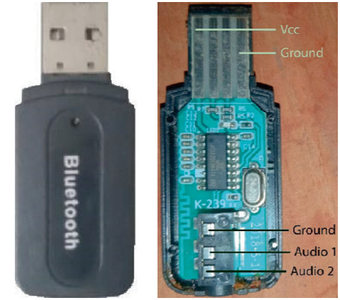

Step 2: Choosing a Bluetooth Audio Receiver
You can use a Bluetooth AUX adapter or a dedicated Bluetooth audio receiver like the MH-M18. If you're using an AUX adapter, ensure the AUX output is correctly connected to the PAM8403 inputs. However, with a dedicated audio receiver, you also have the option to transfer audio via data lines in wired mode, allowing playback without Bluetooth.
