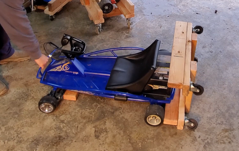

I’d like to share a space-saving solution for storing go-karts. With three go-karts taking up floor space in my garage, I designed a mobile rack that stores them in an upright position. This not only frees up space but also makes it easy to move the go-karts around.

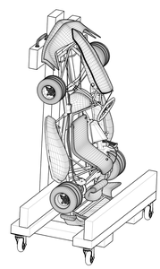

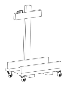

Step 1: Structure and Design
Some features of this design:

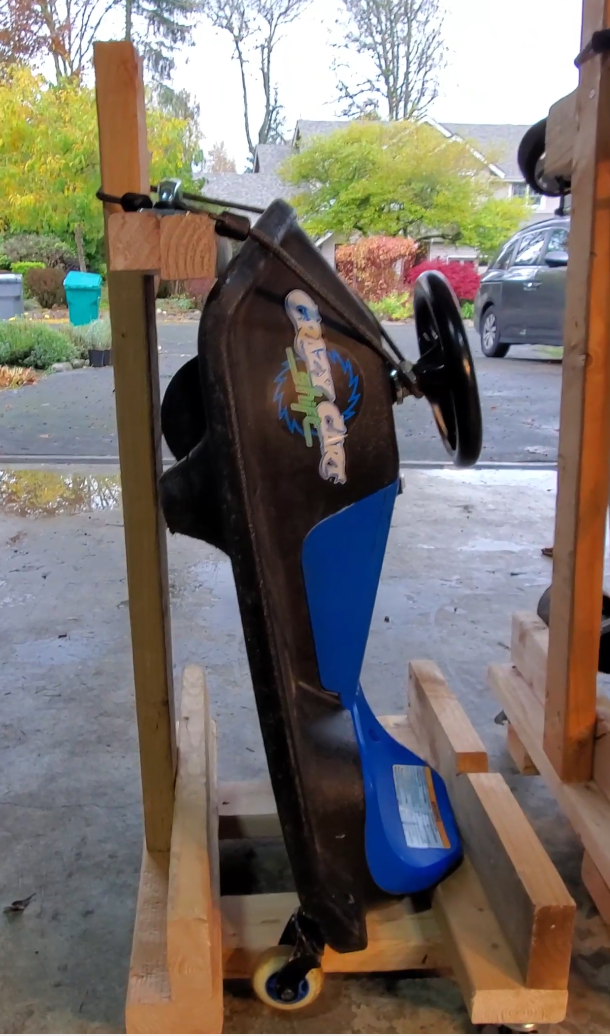

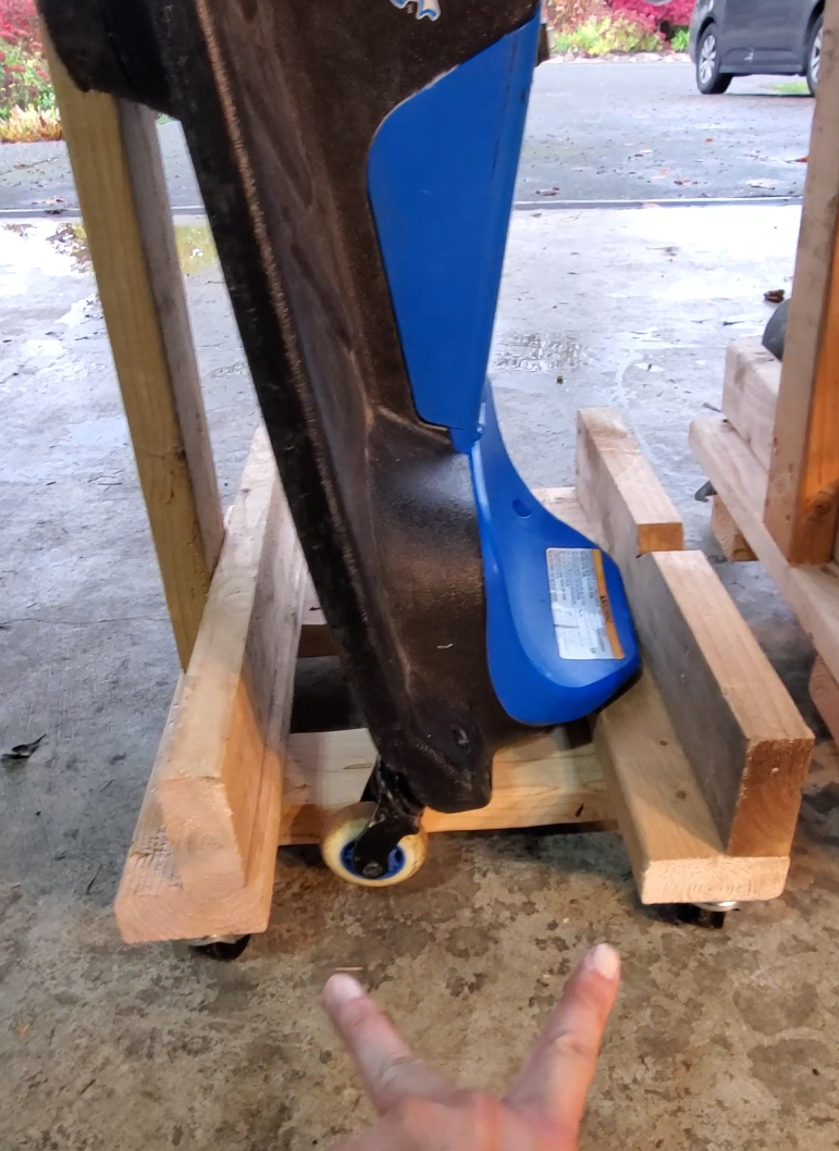

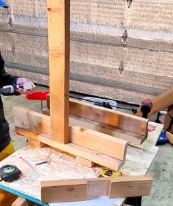

  1. The base of this rack should be wide and deep enough to support the back of the go-kart, which is stored in an upright, slightly angled position.

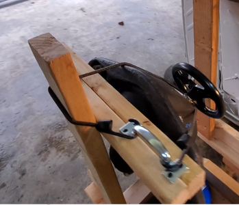

  2. A vertical post with a crossbar provides additional support for the go-kart body while in storage.A pull handle is attached to the rack to easily transition the go-kart between upright and laid-down positions.
  3. A bungee cord secures the kart further.
  4. Four caster wheels on the base make the rack fully mobile.

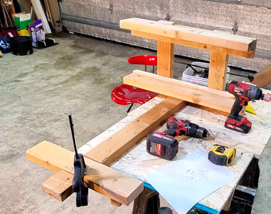

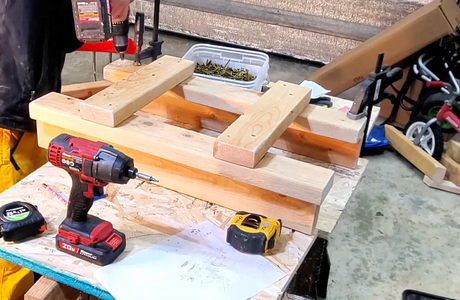

Step 2: Cut, Cut and Assemble
Cut the 2x4 lumber to match the dimensions of your go-kart. Assemble the pieces according to the structure and design provided in the previous section. Finally, add the pull handle, bungee cord, and caster wheels, and you’re all set! I hope this guide is helpful—see you in the next one!
