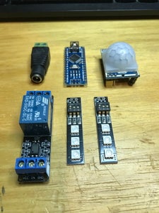

Being simple and inexpensive means keeping the component count and programming time down, so for this project you only need:

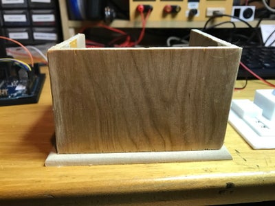

a simple case or box - I used an old frame, cleaned it up and added a printed top
a PIR motion sensor
Arduino (Nano for cost)
(2) inexpensive 12v LED strip (I got these 4 for $9 on Amazon)
Power cable (12v for the LEDs)
Relay
Power barrel
Step 2: Assembly
Assembling is pretty straightforward, so set aside 1-2 hours and you'll be done.

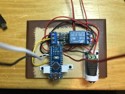

Secure the relay, Arduino and power barrel to the case.
Attach power wires from the power barrel to: relay (center position) and Arduino VIN.
Attach ground wires from the power barrel to: LED1, LED2, Arduino
Attach power, ground and data from Arduino to: both the PIR motion sensor and relay
- Notice you need (2) 5v power feeds, plan accordingly if not using a PCB
Attach power wires from the relay (NO - usually on the left) to: LED1 and LED2

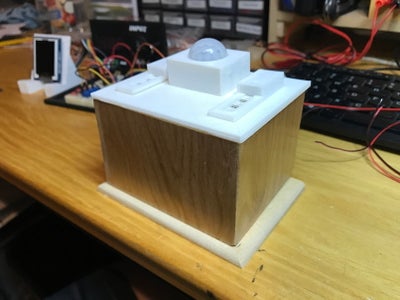

That’s all the wiring, load the program, apply some paint or stain, and secure the loose parts with glue. Your done! To make it look complete, make some frames and attach as covers as needed.
