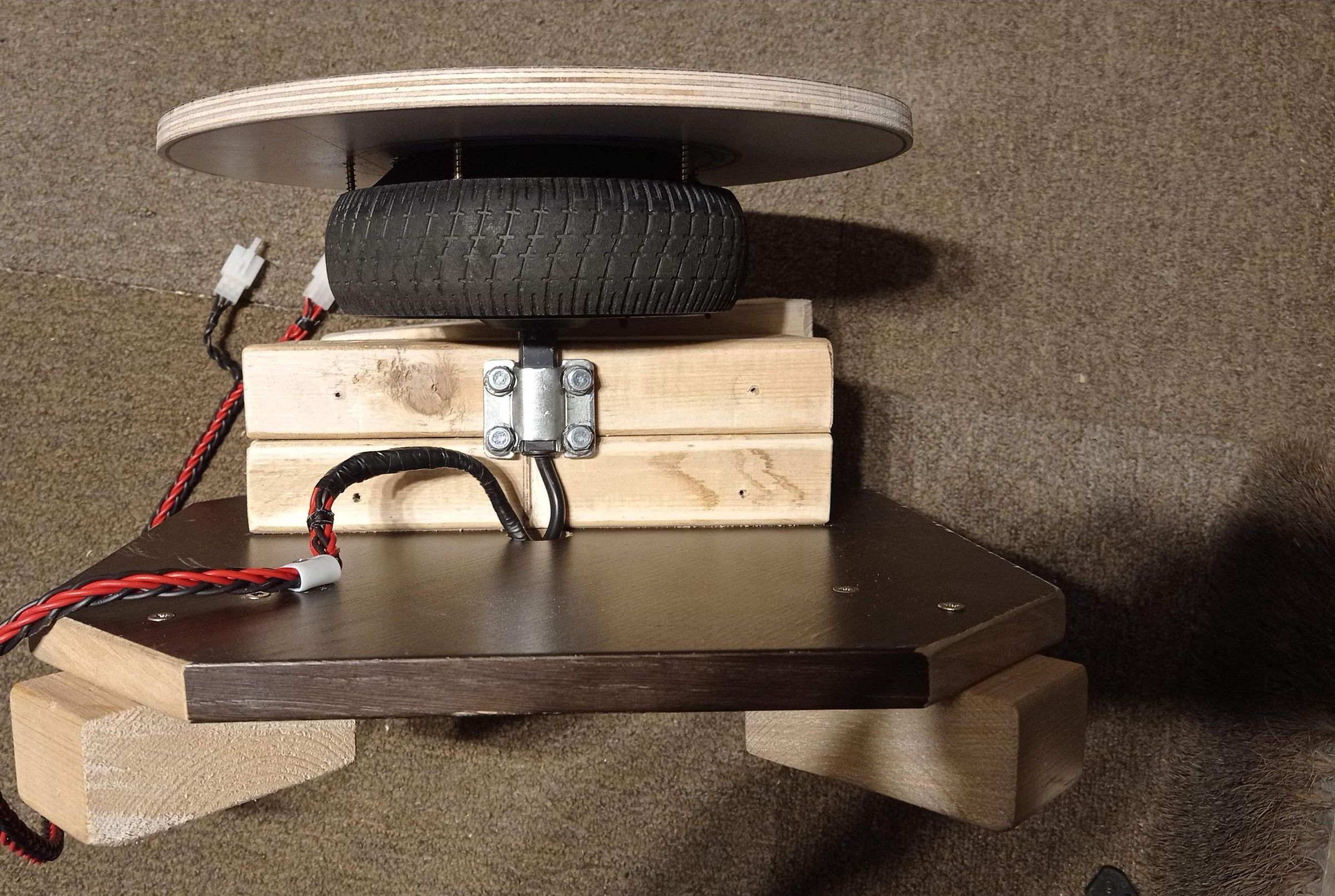

Step 2: Make Motor Mount and Wheelhead
Cut Square Base The motor mount consists of a 335mm square of 17mm chipboard (plywood better) with its corners removed to allow it to fit tightly into the plastic splashpan (IKEA Vessla storage box). If you use a different box measure internal width at a point 60mm above its base and cut the square 20mm wider in order for it to fit tightly as you don't want any movement between the base and wall when you throw pots. The corners of the plywood/MDF base are cut back about 50mm 2inch as the corner will not flex at all, unlike the side walls.
Make Motor Mount Join together two 240mm lengths of 90mm x 38mm CLS timber with 60mm wood screws and cut a perpendicular groove centrally in the 76mm side (photo) using a hand saw. The groove is 10 - 12mm wide and about 3 - 5 mm deep, use the combination square to ensure it is perpendicular. Screw this motor mount to the base from the underside (4 60mm wood screws) so that the groove aligns with a 20 - 30mm hole cut in the centre of the square base. This centralises the wheel and helps drainage.
Add Feet Cut 4 short lengths of 38mm CLS timber and screw to the underside of the square base to act as feet, keeping the base above the pool of water and clay slip that accumulate when throwing.
Fix Motor to the Motor Mount Finally, using four 60mm coach bolts or large wood screws, attach the motor to the bracket using the square metal plate that originally held the motor onto the hoverboard chassis (if you buy a bare motor you will need to fabricate a metal plate) placing the curved face of the motor shaft against the wood and the flat face against the metal bracket (photo).
Prepare Wheelhead Cut out a 280mm diameter circle of 18mm exterior grade plywood (waterproof showerboard better) and mark a 145mm diameter circle centrally, and then drill 5 or 6 holes approx equally spaced along this circle. Later when you can run the wheel you can centralize this wheelhead on top of the motor and then fix it in place with temporarily with Silicone Sealant and then permanently with wood screws that locate into the rubber tyre. These dimensions work for a 6.5 inch hoverboard wheel.
