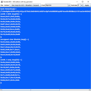

There's also an easier option.
I modified one of my previous projects to work as a random number generator, the generated output seems "random enough" for me, but I haven't run any tests. So, I can't guarantee that it's random.
Use it at your own risk.
To generate the keys - launch gen.exe from the "Untested RNG" folder, and then click the "Gen. keys for AES + Blowfish + Serpent" button. The background turns from black to blue when you press that button.

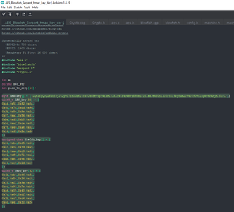

Step 5: Modify the Firmware
Open the file "AES_Blowfish_Serpent_hmac_key_der.ino" and replace my keys with those you've generated.
