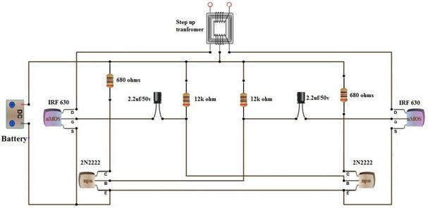

It's very easy to made DC to AC inverter circuit. This inverter circuit convert DC power to AC power. It can be different value and different power.
I will show you convert 12v DC to 220v ac. It will give output about 35 watt. We can get more output to add more MOSFET.

In this circuit, the inverter output will be square wave. It's not a pure sine wave. It can operate 35 watt power load easily.
Step 2: Main Three Part of the Circuit
This circuit is divided in three ways.
  • Oscillator
  • Amplifier
  • Transformer
Step 3: Working Procedure
Working procedure:
50Hz oscillator means 50Hz frequency ac supply. In this circuit, we will get oscillation by R1, R2, R3, R4, C1, C2, T2, and T3.
Every transistor will provide inverting square wave. The value of frequency depend on Resistor 1, R2, and capacitor C1. We will amplify MOSFET T1 and T2 by oscillator power.
Now time to connect the equipment according to circuit diagram. I hope you can do it easily by yourself. It's very easy to do. If you have any question then ask me. You can get more info from here: voltage lab
