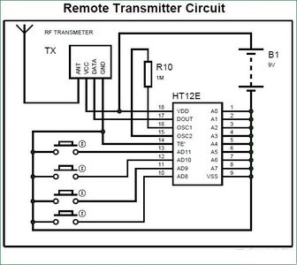

Step 3: Circuit Diagram of the RF Transmitter and Receiver
This diagram shows the complete circuit diagram for the project, including the transmitter and receiver sections.

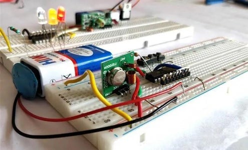

Step 4: RF Transmitter Circuit With a Breadboard
RF transmitter circuit with a breadboard setup
Step 5: RF Receiver Circuit With the Breadboard
As shown above, the RF transmitter circuit has the encoder IC and the RF receiver circuit includes the decoder IC. Since the transmitter does not need a stable 5V voltage, we use a 9V battery to power it directly. On the receiver side, we use the 7805 +5V regulator to regulate 5V from the 9V battery.
Note that address bits A0 to A7 on both the encoder and decoder ICs are grounded. This means that they are both stored at address 0b00000000. so that they both share the same address and they will act as a pair.
Data pins D8 to D11 are connected to the buttons on the encoder side and to the LEDs on the decoder side. when the buttons on the encoder side are pressed, the information will be transmitted to the decoder and the corresponding lights will be switched.
Step 6: Operation of the RF Control LEDs
I have built the circuit on two separate breadboards, both powered by a separate 9V battery. After building them, it should look like the diagram below.
Power up both breadboards and you should notice that the LEDs will start to glow. Now press any button on the transmitter breadboard and the corresponding LED in the receiver circuit will turn off.
This is because the button pins (D8-D11) are internally pulled up by the encoder IC. Therefore, all three LEDs will be illuminated and when we press the button, the data pin is grounded, so the corresponding LED on the receiver side will turn off.
