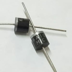

-Diodes 6A10 MIC 4 pieces.

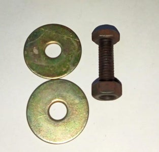

- A screw and nut and 2 fender washers.

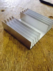

- An 5x10 cm aluminum fin heatsink.

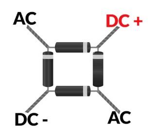

Join the diode wires to make a bridge rectifier according to the pictures, followed by bending them 90 degrees according to the picture.

Put the bolt, washers and screw in the hole in the middle of the bridge you made and secure it with the proper wrench. Solder all the male connectors to all joined wires.

Connect the joined bridge to the heatsink and secure it. Connect the joined diode legs to the transformer cables and two (+) and (-) output cables following the diagram above.
