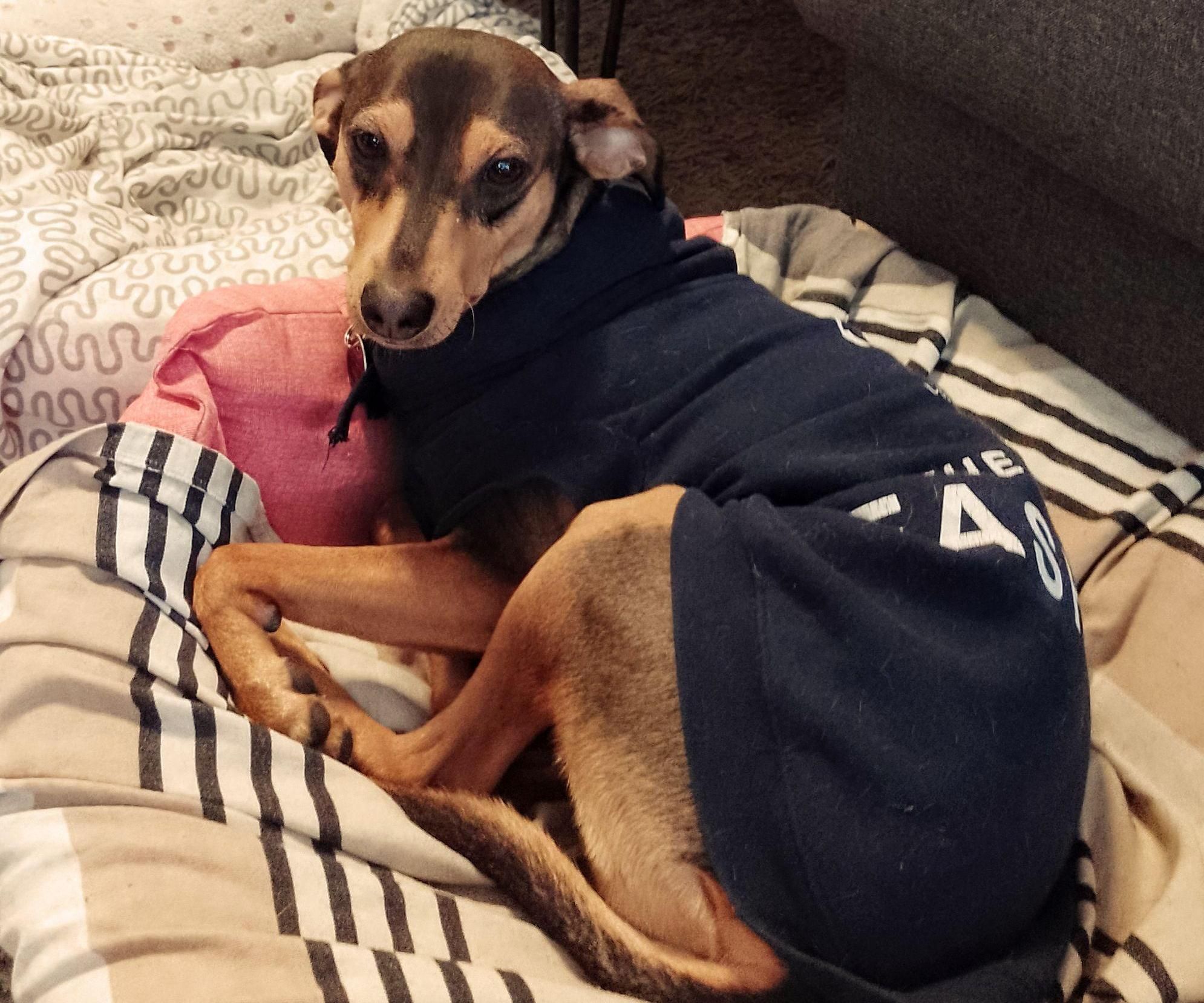

Since my dog easily gets cold in winter, I started making different variations of this simple dog jacket. The design is based one a jacket a friend gave me, which I really liked, because it is vey easy to put it on and take it off (thanks to the Velcro). Aside from that, it is also easy to make.
I would say this jacket is a perfect size for smaller dogs. For reference: my dog is approximately 30 centimeters tall and weighs around 7 kilos. Thanks to the Velcro, I expect it will fit most small dogs well. I never tried making it in a bigger size, but if I do I will add it here.

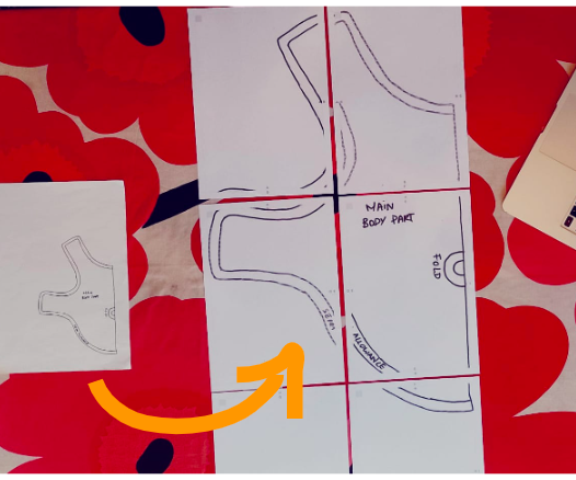

Print the pattern in the attachment (3 pages) and connect the parts correctly. The jacket only has two parts: the main body part and the collar. The main body part is symmetrical, so it should be cut with the fold of the fabric to the indicated side. It can also be cut in two halfs and then sewn together (I did this a few times when I lacked a big enough piece of fabric), but make sure to add some extra seam allowance to the side of the fold if you do this.
The jacket consists of two layers that will be sewn together, so the pattern needs to be cut in both the main fabric and the fabric for the lining.
