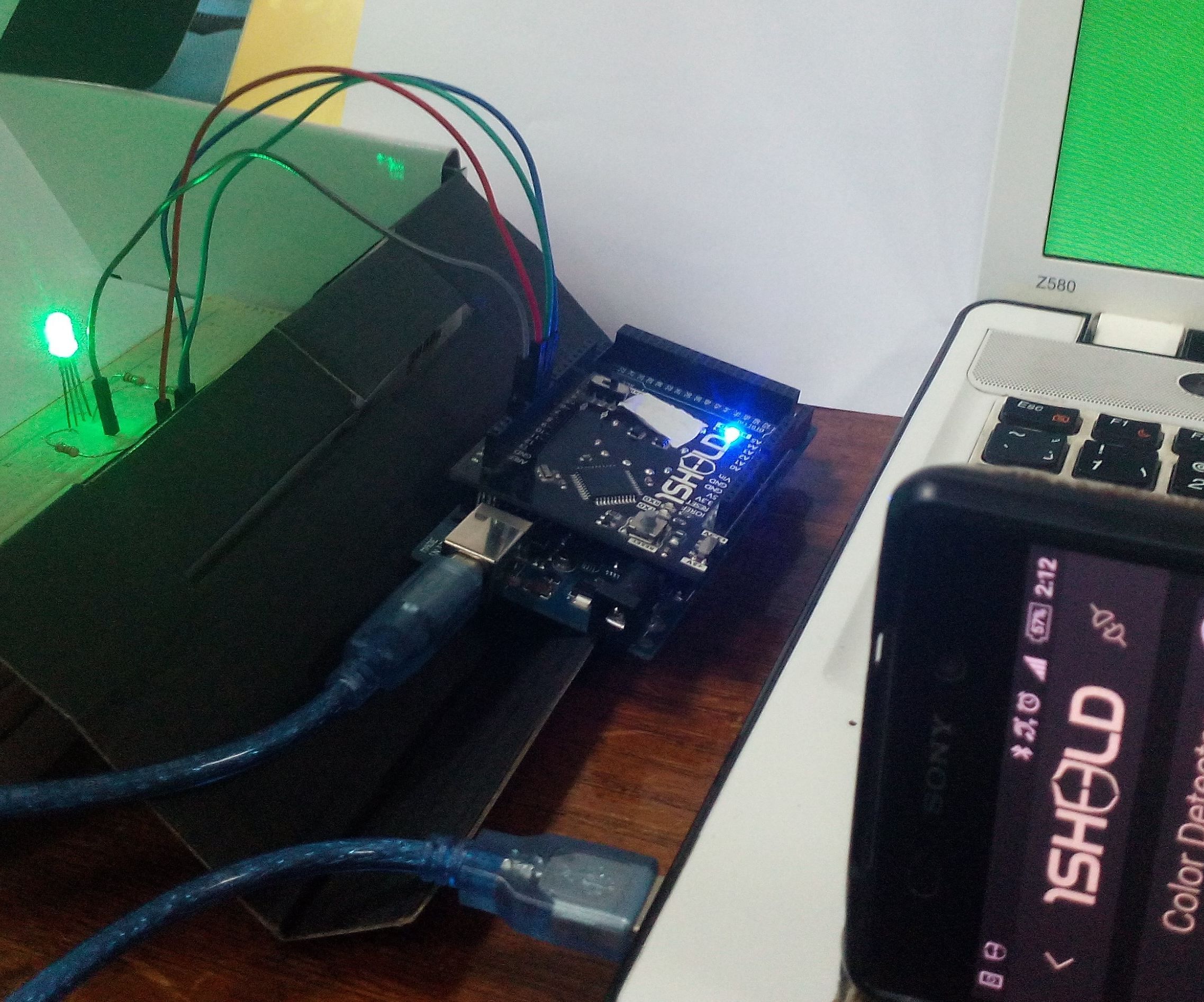

1.mount the 1sheeld on the Arduino board
2.Make sure the power switch shown above is turned to 5V (for Arduino UNO users) if you're using another Arduino board check here
3.Connect the ultrasonic sensor and the wires as shown in the figure.

After connecting all components as shown.
Connect the Arduino to your laptop and make sure the code is uploaded.
Switch the 1Sheeld back to operating mode.
Open your 1Sheeld app and connect your phone to your 1Sheeld board.
(Check 1Sheeld tutorial here if you haven't already).
Select Media Player Shield, and press on the multiple shields icon at the top right of the app.
Now, put your circuit and your mobile phone in a hidden place and enjoy your prank.
